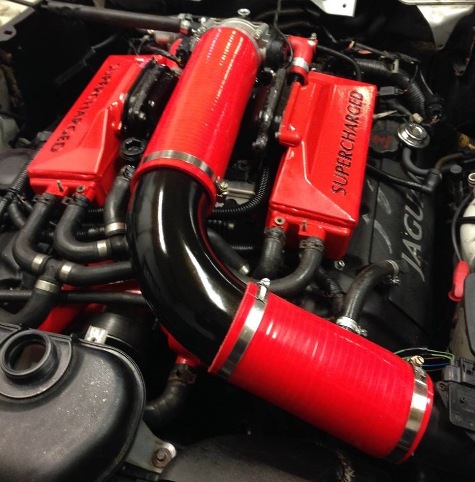

This how it is now , still more work to tidy it up some , but all works ok for now
sorry for the size of pic ( im just glad i managed to post pic )

VERY interesting design of the throttle-body eblow to the blower-inlet...
The position of the throttlebody is MUCH different than stock... yet stil a stock throttlebody nonetheless... interesting...
Nice results avos, this is effectively putting out more power than the modified 5.0SC cars put down!

That was a useful picture of the XJR setup but the XKR would route the intake very differently I think. Is there a similar picture of that about?
