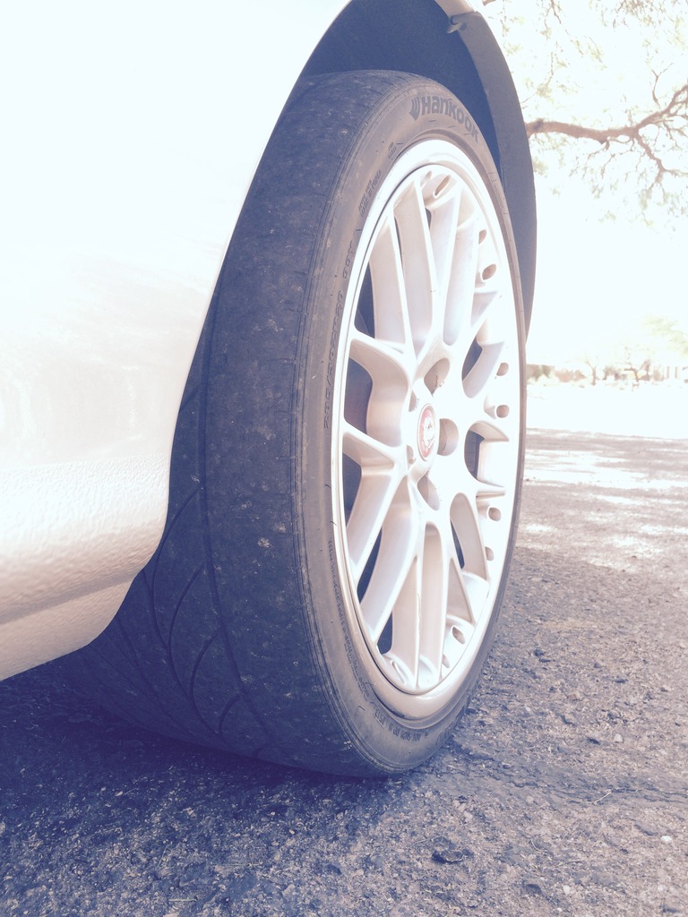

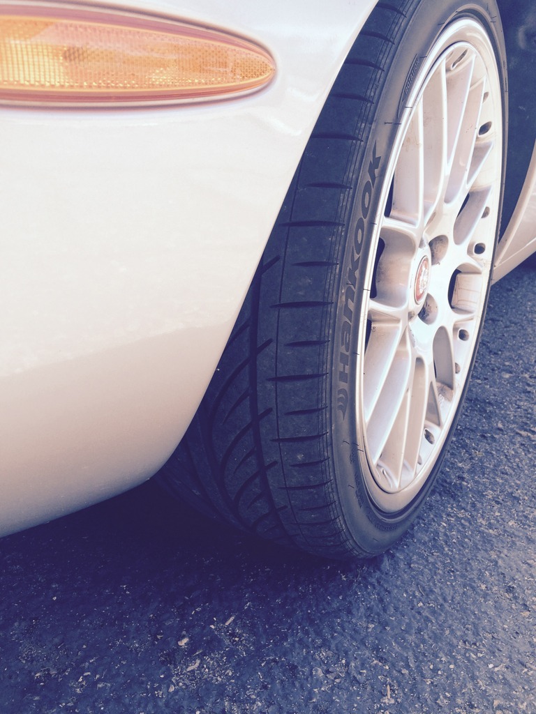

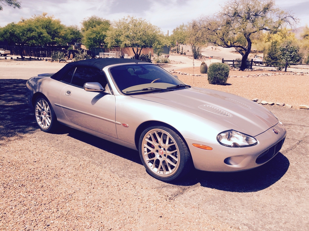

I had been off of the forum for a while as I built up an offroad Land Rover. I finally got the XKR back in action!
The problem turned out to be a switch under the J gate shifter. There was an old Technical Service Bulletin about the issue that had never been addressed. As that was dealt with, I had Falconworks install a monstrously huge fuel pump into the driver's side front fenderwell to act as a 'supercharger' for the existing fuel pumps. Since I'm running a smaller pulley, the car needed even more fuel delivery. Perfect!
Guys, this supercharger kit makes your car C-R-A-Z-Y fast. I hammer on this thing every time that I drive it. Now, it's time to go get some new back tires (the front ones are still like new).
