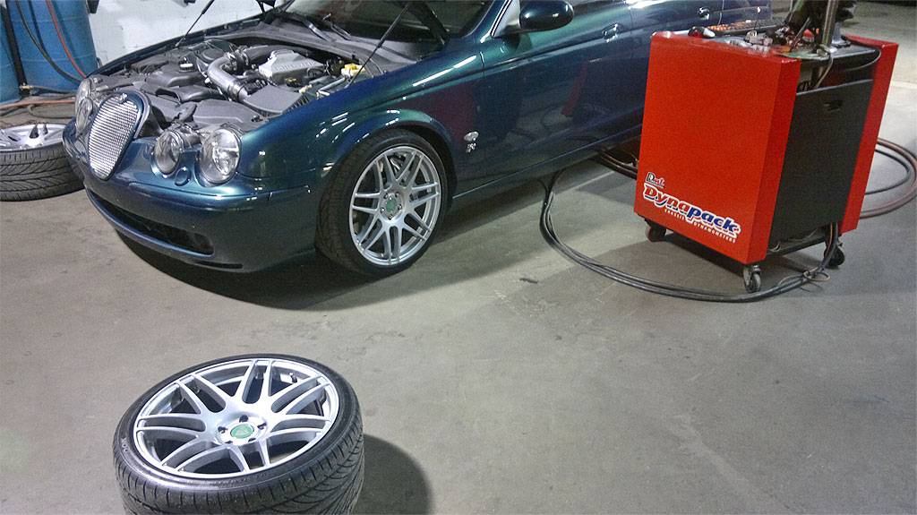

On Friday evening, I stopped at dynamotorsports.ca to get a baseline power measurement on Tony's dynapack dyno.
Although Eurocharged operates their own dynodynamics dyno, I opted to do the before and after testing on a 3rd party dyno for best results.

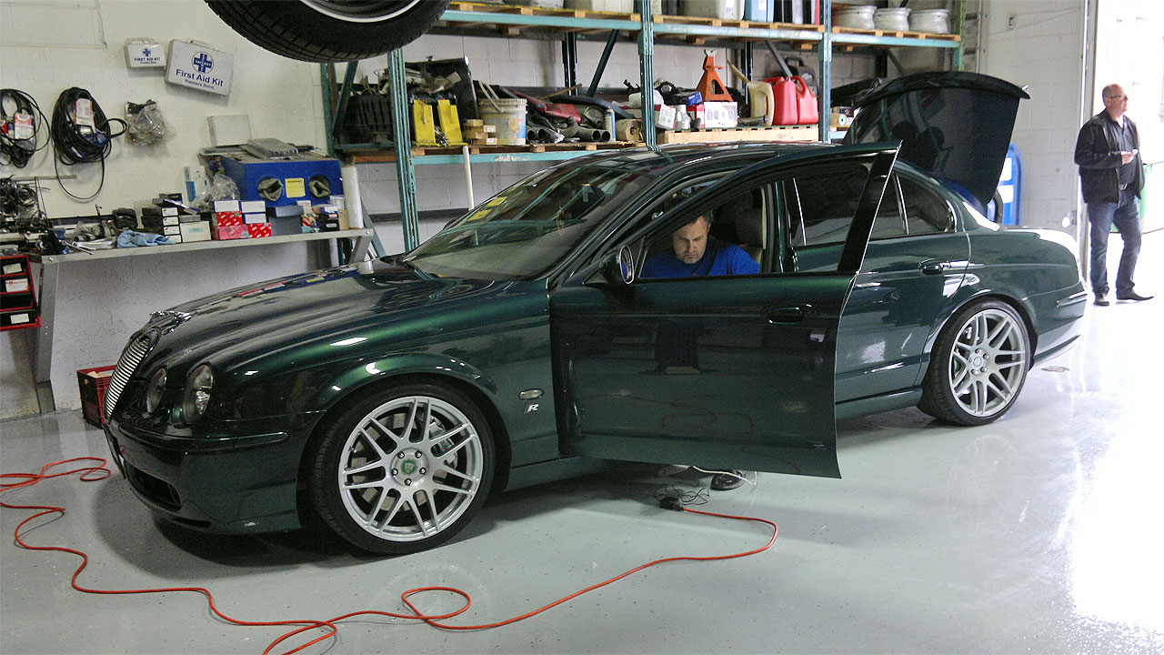

I arrived at Eurocharged Canada on Saturday morning for their open house dyno-day event. Jerry among other Eurocharged staff from Houston and D.C. were on-site! A large number of customer cars, mostly the BMW and BENZ crowd, were all being flashed and dyno tuned by Eurocharged this day.
Jerry proceeded to explain how all their tunes are engineered from many hours of datalogging and tuning of customers cars on the dyno and street.
He has tuned many examples of our 4.2SC jags in the past, and has a good background of data to be able to customize a tune specifically to my application and mods.
After picking his brain extensively, I was left feeling very reassured Jerry knows exactly what he is doing.
He asked me about what mods I had done to the car, specifically, what size pulley I have equipped.
Jerry explained how there are over 4,000 'maps' within the calibration file of my ECU, effecting a very wide range of operating conditions, half of which are modified for the 'tune'. In other words, expect an improvement in performance and fuel economy over an extensive range of engine operation, in both open and closed loop.
According to Jerry, my tune is slightly conservative, and there are gains to still be made if I would like to hook my car up to the dyno and have him further customize it to suit my car.
Jerry himself personally tuning my STR yesterday! After 'reading' the stock calibration, he disappeared to a room for an hour, diligently editing it before returning to load the modified calibration onto the ECU.

After loading the tuned calibration onto the ECU, we disconnected the battery for 30 min, and watched a Ford GT dyno 600hp...

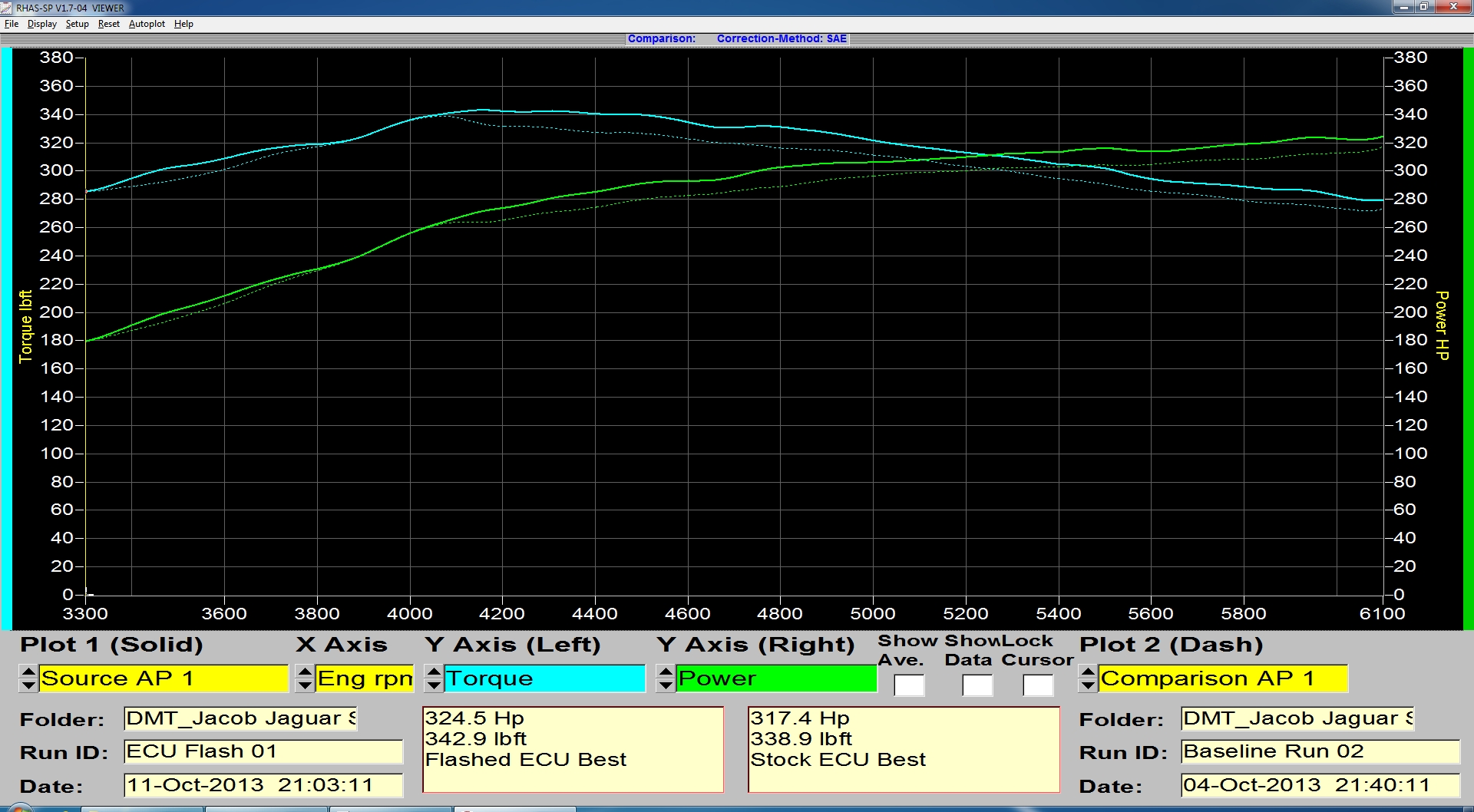

I will lead with last Friday's results, these are my 'baseline' results before getting flashed with the eurocharged tune, these are the peak numbers,
First pull: 310.7hp / 335.6lb-ft
Second pull: 317.4hp / 338.9lb-ft (BEST, SHOWN BELOW)
Third pull: 306.2hp / 326.1lb-ft
With the Eurocharged tune, the following Friday's numbers:
First Pull: 324.5hp / 342.9lb-ft (BEST, SHOWN BELOW)
Second Pull: 321.5hp / 342.0lb-ft
Third Pull: 315.4hp / 333.4lb-ft
We then disconnected the negative battery cable and touched it to + in order to do a 'ecu reset', and performed a fourth pull to note any difference,
Fourth Pull: 322.6hp / 332.7lb-ft (ECU Reset)
Here we overlay the best of stock tune VS best of eurocharged tune results;
In terms of peak numbers, the eurocharged tune gained 7.1hp, and 4lb-ft of torque.First pull: 310.7hp / 335.6lb-ft

If you look closer at the dyno chart, and examine gains at other parts of the powerband, you'll find gains between 10-15lb-ft of torque in a few spots, as well as 10-15hp along the entire run.
This roughly 10-15hp gain is visible and consistent across the whole powerband,
So there you have it folks, not a wild gain, but that was somewhat to be expected. If you look beyond the peak figures, you will see there is a small bump across the whole powerband.

Stock Tune:
Eurocharged Tune:
Third Pull: 315.4hp / 333.4lb-ft (let off early)
After going through some datalogs of the dyno runs, I would like to clarify and expand on a few things,First pull: 310.7hp / 335.6lb-ft
Eurocharged Tune:
On the third dyno run with the eurocharged tune, we netted 315.4hp / 333.4lb-ft,
This run the dyno operator slightly let off around 5,000rpm due to ping, and did not complete the pull at 100% throttle.
I wouldn't consider this a 'valid' run,
The fourth and following pull, we netted 322.6hp / 332.7lb-ft,
So, lets average the three stock tune runs: 311.4hp / 333.5lb-ft,
Now, lets average the three tuned runs (1, 2, exclude 3, and 4): 322.8hp / 339.2lb-ft
This results in an average gain of 11.4hp and 5.7lb-ft, figures which looks a bit better than the two best before/afters overlaid,
Looking at the each set of three dyno runs, suggests the eurocharged tune puts out more consistent power, a good thing... maybe...
Further more, based on the logs, the dyno operator was trying to avoid the transmission kicking down from 4th to 3rd gear, so he would be about 80-90% throttle into the 4,000+ rpm range,
This sort of effects the peak torque figures as it sort of depends on when the dyno operator chooses to hit it, so take it with a grain of salt, but i believe we could establish a better idea of overall torque gain if it was possible to dyno a little lower in the rpm band,

GT42R, pls excuse this dumb question, but I see that your rear wheels have been removed. Is this the latest technique for doing dynos without damaging tires, or am I missing something?

Robin, the rear wheels were removed for my dyno run because it was being tested on a DYNAPACK dyno, which bolts directly up to yours hubs. This is far superior as you don't have to worry about traction issues, strapping down the car, etc,

Today has been rained out, but rest of the week looks clear, so I hope to be back on the dyno at dynamotorsports as early as Tuesday evening, I will be posting and and analyzing the torque curve on the dyno graphs as soon as possible.
I datalogged ignition, fuel, and other parameters through the OBD2 before the tune, and will compare it to the latest data with the tune as well.
Once I get some more seat-time behind the wheel, I'll have some initial impressions to share as well.
I too have done the dyno-proven mods, and quite frankly, small gains aren't easy to pick up on.
Heck, I did the 3lb pulley install, which everyone raved about as providing a 'night and day' difference in performance, and quite frankly, that too was barely perceptible (slight exaggeration).
I think this has to do with several factors. For one thing, the STR's powerband and power delivery is exceptionally smooth. The torque curve is flat as hell, hardly peaky and not exactly the kick in the pants feeling from a turbo hitting high boost.
This butter-smooth power delivery through an automatic means you feel a steady pull, and it's not easy to pick up on gains.
Furthermore, I consider myself a bit desensitized, as I am used to some very high-hp cars on a regular basis, and the STR quite frankly is pretty slow and sedate no matter how I look at it.
I'm also really sensitive to placebo effects taking place, so last thing I want to do is come on here, raving about how the tune completely transformed the car, and end up overselling everyone on its gains. I will reserve final judgments until I play with the car a bit more.
I drove the car a bit yesterday, and I am certainly picking up on changes, particularly, in the part throttle blasts between 1,800-3,600rpm, where the car definitely seems more responsive. The upgraded pulley did bring more power to the car down low, and it is entirely possible the tune is taking advantage of additional power available at lower engine speeds/throttle positions that under stock pulley conditions just weren't there.
Based on what Jerry was telling me, 2,000+ of the 4,000 maps within the calibration file have been altered.
What this means to me is expect refined performance over a wide scope of engine operating conditions, including fuel economy improvements, which in itself offsets the cost of the tune over time (however marginally).
If anything, the gains might be even LESS perceptible than one may think. If they did as comprehensive a job to the OVERALL engine calibration as they claim, not just WOT/peak power adjustments, it would stand to reason the power delivery and torque curve was FURTHER smoothed out,
This 'smoothing', if anything, would mask what gains might have been otherwise noticed if they were more crudely implemented.
Regardless, how much additional power can we reasonably expect? I do not focus on PEAK gains either. I will be pouring over the torque curve in great detail, to see if there is a marked difference across a wide range. The factory eaton blower is really at limits even in stock form, so I do NOT expect massive PEAK HP gains; what I do want to see is a bump in and around peak torque.
I still think what eurocharged prices this tune at is a bargain relative to what other guys want (double-to-triple the price) for what seems like vapor-ware in most cases.
I set out to datalog, dyno and test this tune at my cost in order to to enrich the communities understanding and potential benefits of such a product.
Ultimately, it is up to end-user to determine if such a tune is going to be 'worth it'. With all the bolt-ons exhausted for many of us, this tune is the only thing left to count on in helping eek out that last bit of power.
I am the last person you would expect to be an apologist, or try to play down any shortcomings, and I'm not here to sell eurocharged products to anyone. I am just as critical about this sort of thing as the rest of you.
I am going to present and disseminate all my findings to the best of my ability, everyone is free to draw their own conclusions, and the value-proposition of this mod is going to be relative to each individual owner.
