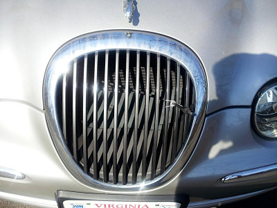

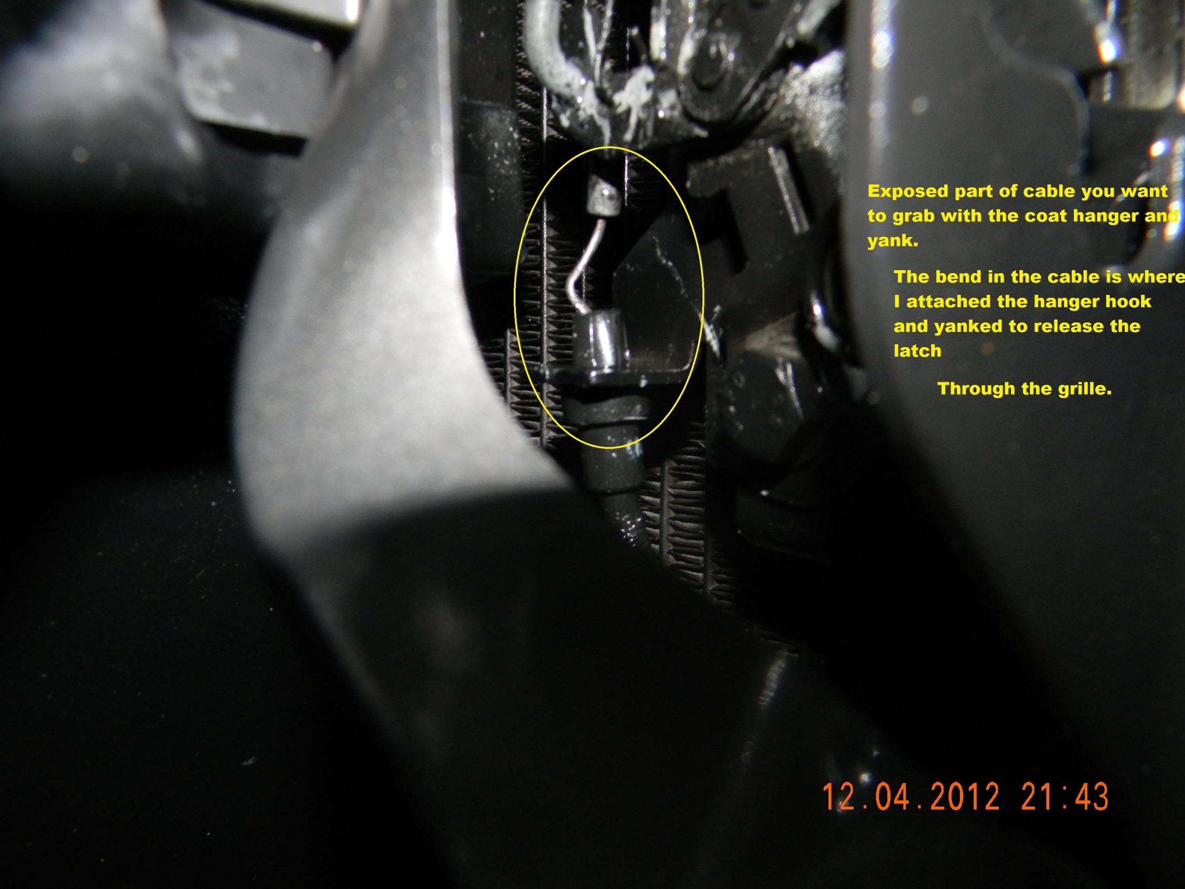

Same thing happened to me! It is the cable that goes between the 2 hood latches. Don't try getting to the offending latch from underneath the car - won't work and you'll get frustrated very quickly like I did!
What you do is (daytime! - I did the following at night and natural daylight would have helped) - get a hanger and make a tight loop at the end and bend at a 90 degree angle - fish it through the front grille and wrap the end hook around the cable right near the passenger side latch - you will more than likely see the exposed metal cable and pull - hopefully, you'll luck out like I did and disengage the other latch.
Once you get the latch open - on the hood - remove the 2 bolts that have the metal loop that goes into the latch until you replace that cable. This way you can lock the hood (only driver's latch will lock) and drive around until the replacement cable arrives...
The cable replacement is pretty straight forward. Just take your time removing the cable from the plastic retainer clip on the front end assembly - you break that and the cable will just hang there... Good Luck!

The mirror may help but the cable will be easily seen behind the grille - the trick is to catch the cable right near the passenger side latch and yank it hard. Don't try the magnet to get the exposed cable - won't help.
Remember, once you get the hood open - remove the loop on the hood itself so you don't lock the hood up again until you get that cable replaced.
Here are a few pics from my experience.
Attached Thumbnails **help now please** hood won't open on 2001 s-type-dscn2139.jpg   **help now please** hood won't open on 2001 s-type-dscn2141.jpg
