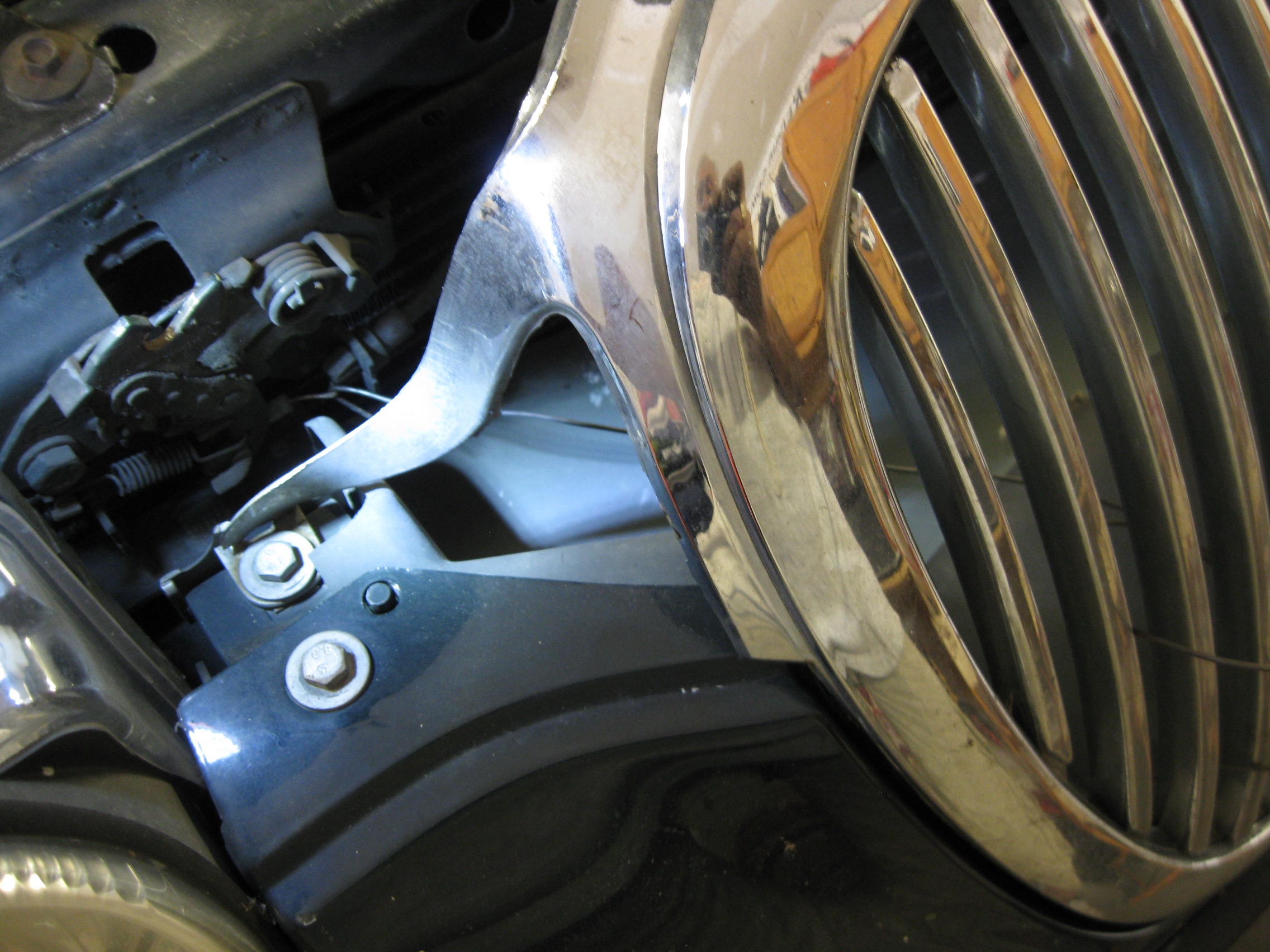

Here are some pics of the latch that attaches to the main hood latch cable. I took the pics from the grille perspective.
I also included a pic of the latch up top looking towards the bottom of the car. As you can see there's no room to work with from the bottom of the car.. and the latch is on top of a flat metal plate which prevents access from below.
Hope these help.
Anthony

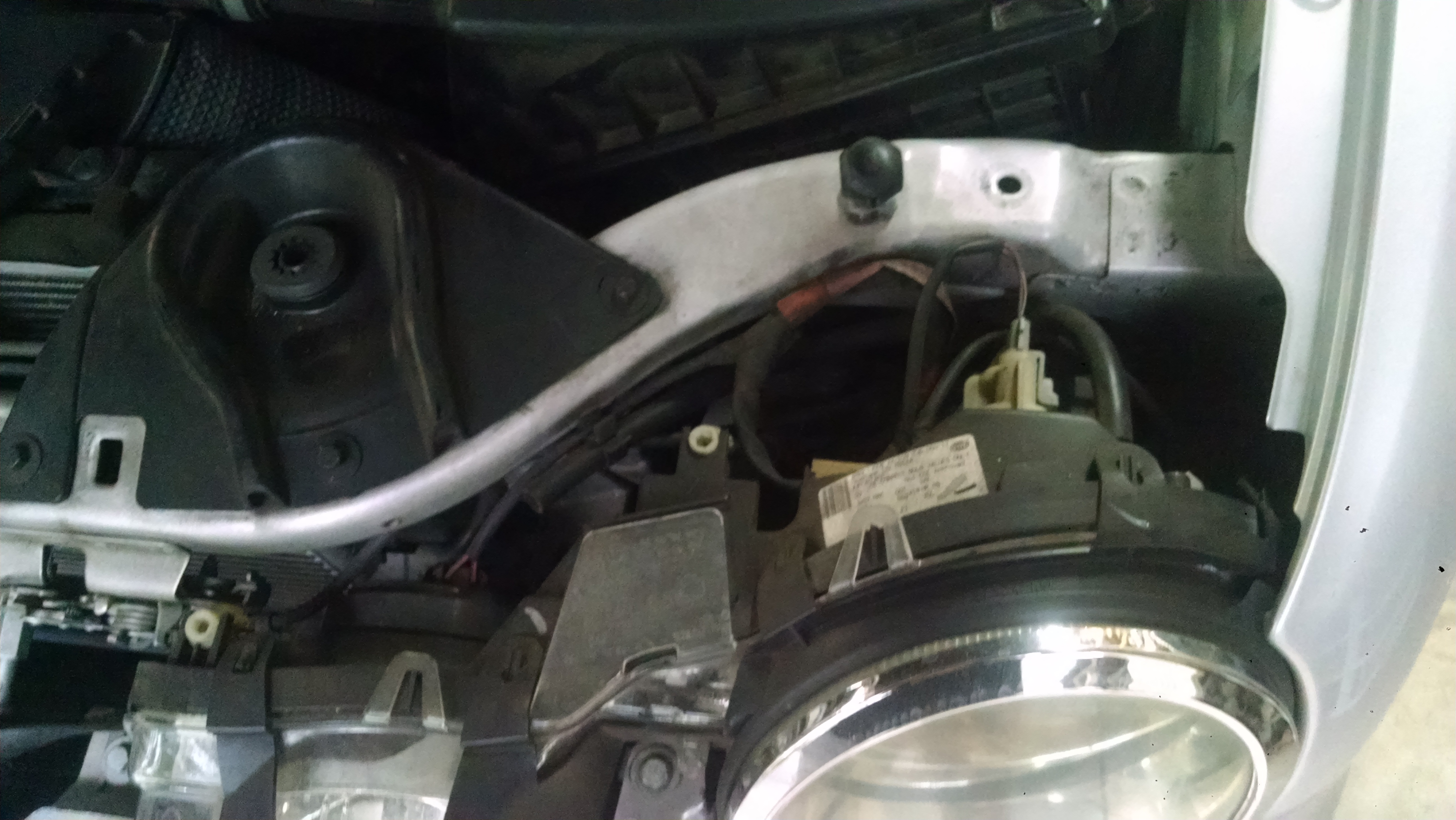

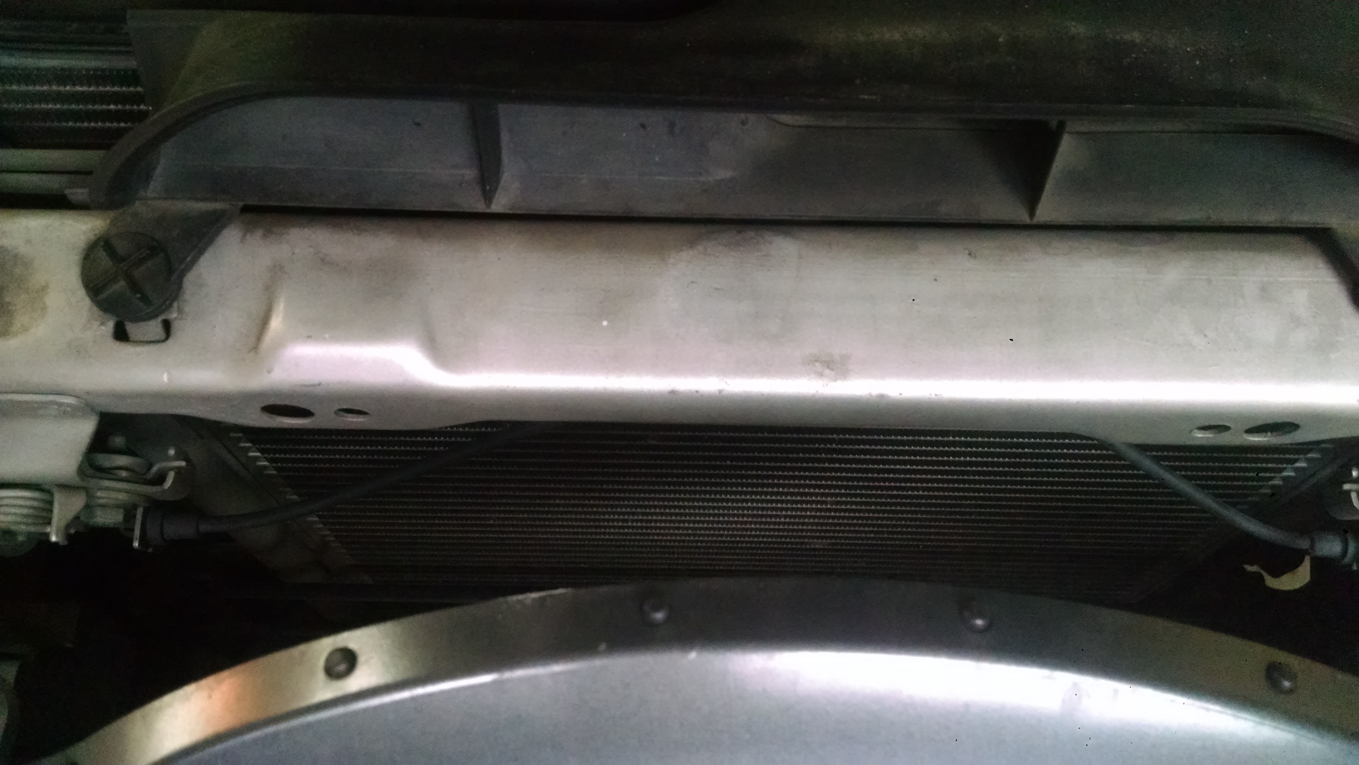

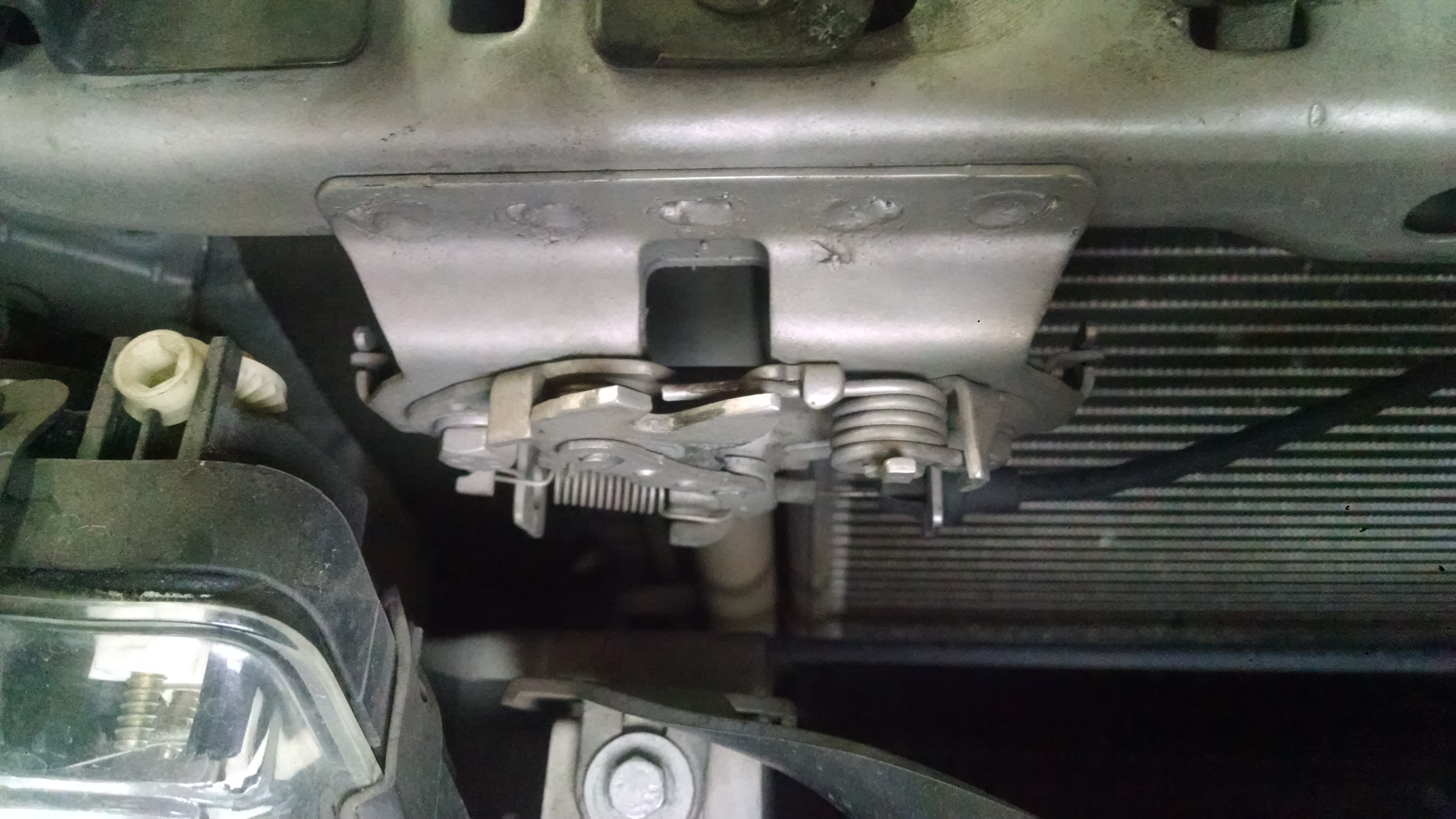

See if these help:
2005 MY, 3.0, North American Model
I do not have time at present to enlarge the photos and explain. If the powers that be will allow me to come back and edit then I will do so.
Hope this helps a bit.

Thanks!
I now have the new parts so next is to examine everything more.
Even at a quick look yours is quite a bit different, rather to my surprise.
