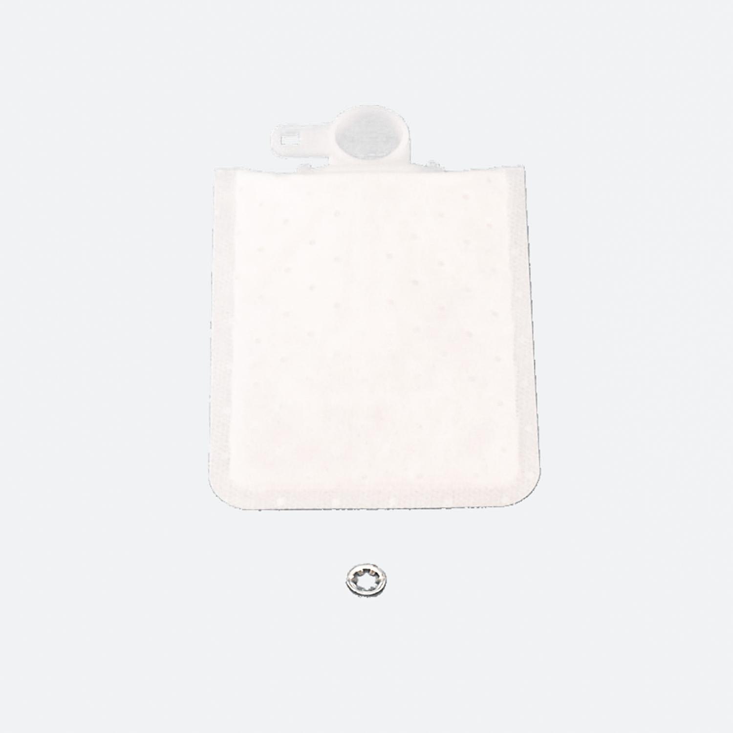

Have you ever changed the fuel strainer that is at the fuel pump in the fuel tank? It looks like this...
Its job is to strain out larger crud before it gets to the fuel pump...
Dropping the tank sounds like fun. But I have only done it on a Ford F250 with a V10...
I can put the Jag up on ramps. How hard is it to get to this "strainer"?
Thanks.

Might you be able to get at it from above? I believe the tank top is accessible to some extent under the rear seat.
The tank's plastic, as I recall, so I'd hope there actually would not be anything in the strainer. (As if!)
I'd need a compelling reason to drop the tank. I'd prefer to read the fuel pressure and if there's plenty even under load I'd be fairly sure the strainer wasn't an issue.

Both fuel pumps are serviced from above. Remove the back seat bottom cushion and you will find the access doors. The Jaguar has two pumps. One is a "Jet" pump that only transfers fuel from one side of the tank to the other. The other pump is the main or normal pump that supplies the engine.
When the jet pump fails the car will run until you get somewhere between 1/2 and 1/4 of a tank then it will run out of fuel.

Yes. The 3.0 operates the same way. I would for sure change my fuel filter before anything else. I have always replaced the fuel "sock" when installing a new fuel pump. Most but not all fuel pumps come with a new strainer.

What does one have to do to take the back/bottom seat out? It is great they made the fuel pumps that easy to work on! Incredible!
