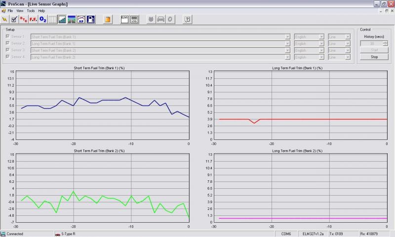

here are a few graph- didn't have much time but wanted to get something quick
2500rpm is interesting between bank1 and bank2

With fuel trim so large at idle on both banks and much less at 2500 it looks like you have an air leak.
On an STR it's usually the air box, filter, or tubing from there towards the engine.
hmmmm, i'll have to take another look at the intake- good catch
what do you think about the large discrepancy between bank1 and bank2 on the 2500rpm SS?

See what it's like when (if) you find a leak?
