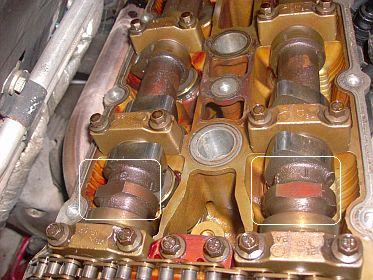

You might pull a cam cover to just take a look? The timing chain problem can cause one or both cylinder banks to jump a tooth.
You can turn the engine over to verify that the cams are in time pretty easy. The factory has machined a flat on each cam. They MUST be aligned for everything to work right. Here are two cams just slightly out of time. Most likely by one tooth only. You have not posted the mileage but don't discount this as the problem. The 4.0L engines will all suffer from this eventually. They will fail completely too so run them at your own risk!
