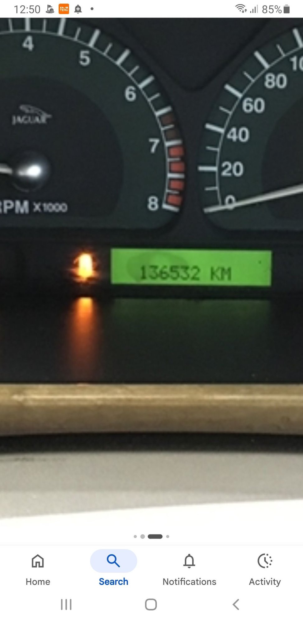

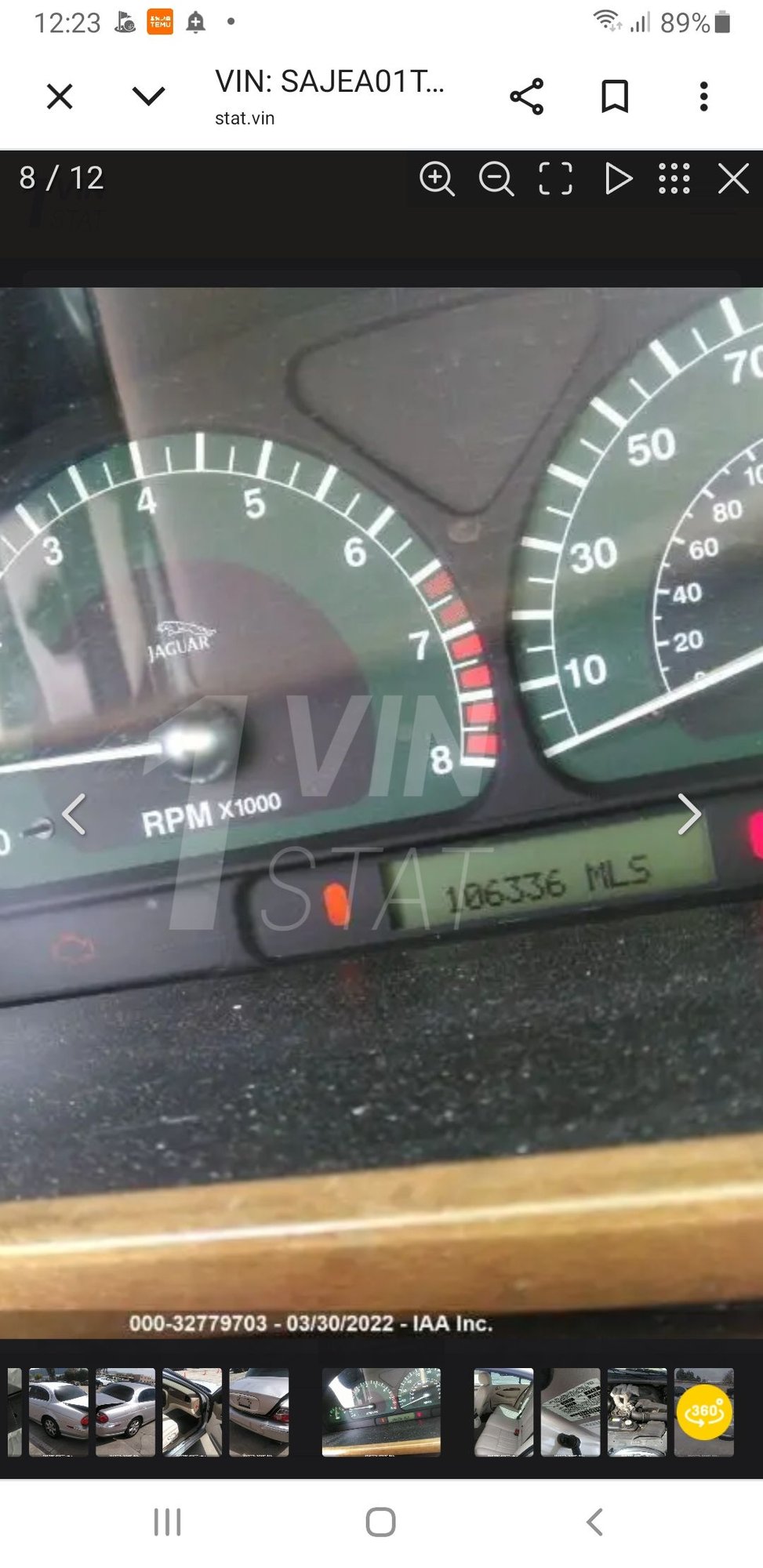

But have taken some screenshots from the net
first screenshot is what mine looks like even with lights on
dark all the time
Second screenshot is what i thought it should look like

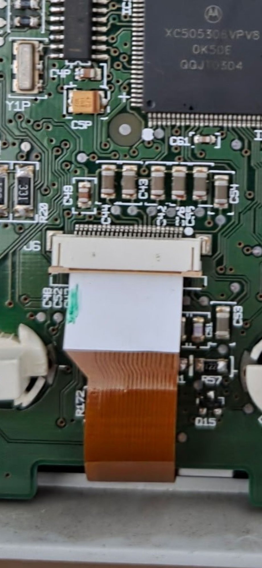

This is what I found out today
On the s type instrument cluster
The LCD display /message center is dim there are two
T5 2721 or 194 size wedge bulbs on the printed circuit board
​​​​​for the LCD message centre backlight
But that is only if you can read the messages/ mileage
Like in first post

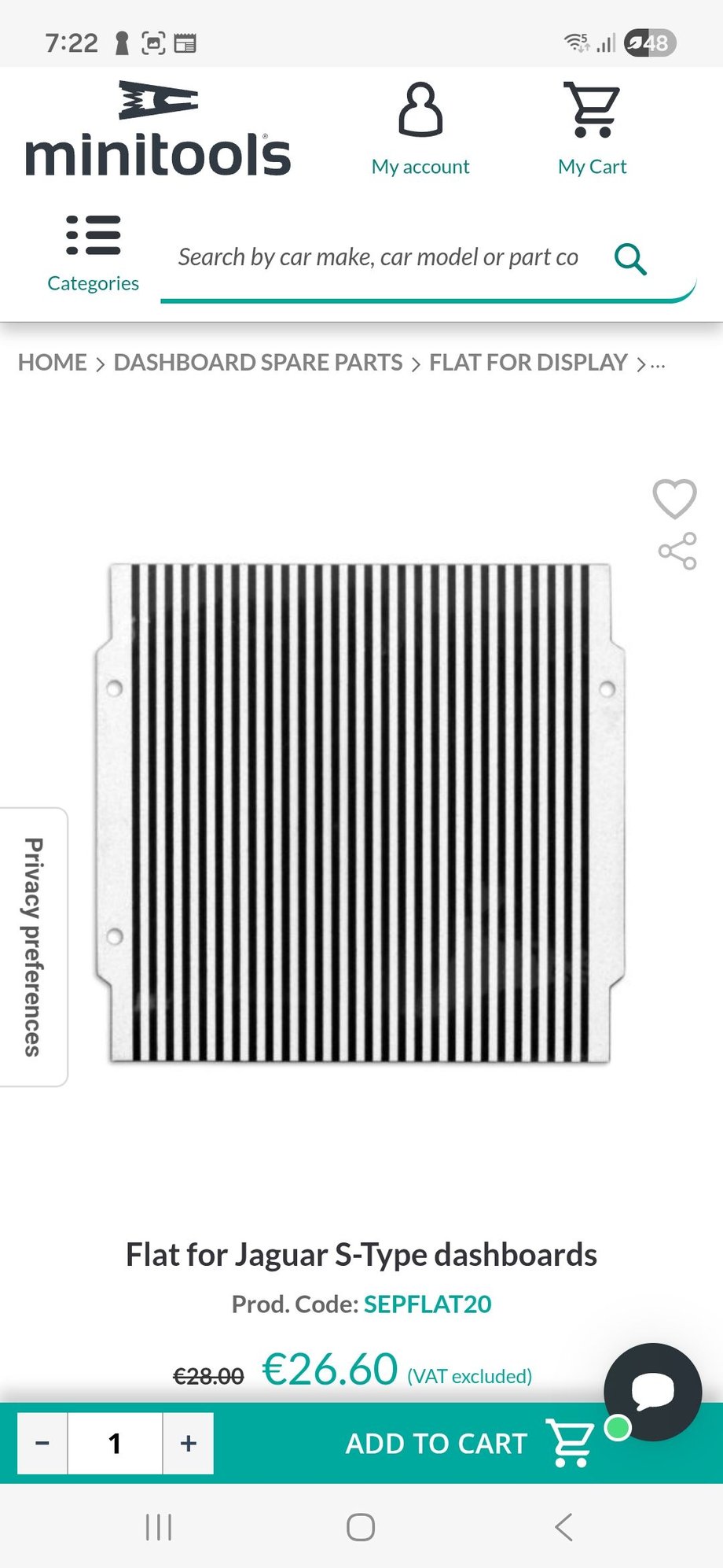

If you can not read messages or missing letters then the ribbon cable can be replaced
But this is where I'm not 100% sure i have been told this is the correct ribbon cable
But it looks different to one on my cluster
Also the two wedge bulbs either side ribbon are for
LCD Backlight
Thanking you
