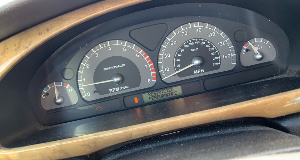

Hello! Turned on my jag today (2003 STR, 128k miles) and saw a “restricted performance” message on the dash. Seems to be driving exactly the way it was before this message popped up. Went and got the codes for the check engine:

Hi, I am not sure about the other codes you have, but if you know that you got a knock sensor fault message, that would be worth looking at. When I bought my XJ8, it came with restricted performance (plus I could not exceed 3000rpm), I connected a diagnostic scanner and it told me it's the knock sensors. I swapped them and problem solved.
