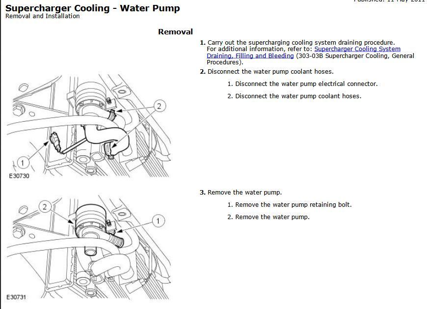

Looks like the intercooler pump is mounted low, just forward of the radiator, on the US passenger's side:
See pages 1360-1370 here:
http://www.jagrepair.com/images/Auto...M-Workshop.pdf

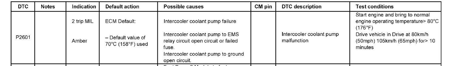

Originally Posted by Dwayne Mason
I'm hearing this should do it?
Here is the exact error. Don't overlook that you could have a bad circuit, which could be related to heat that builds builds up too much resistance. I have had that problem with my O2 sensors and it was part of the circuit that needed repairing and would only happen in the summer. The original circuit showed higher resistance, but not over the threshold of the code, but the summer heat of Texas, would cause a code being thrown. Verify if the pump is running and if it is look along the circuit and do some pinpoint testing.
Tom in Dallas/Plano
