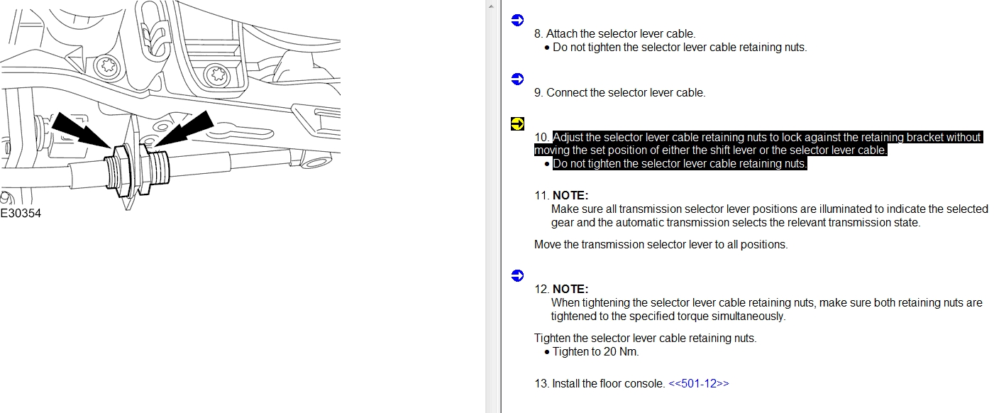

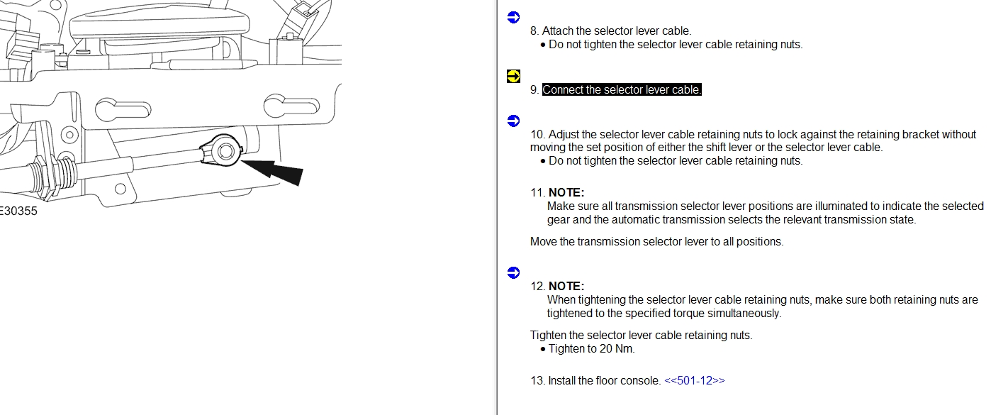

See if this helps.
Attached Thumbnails 2004 s type 2.7 Diesel no start, no crank!-stypeshifteradj1.jpeg   2004 s type 2.7 Diesel no start, no crank!-stypeshifteradj2.jpeg
