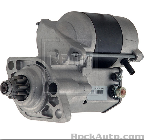

Per Rock Auto, here's a view of the starter:
It looks to be a gear reduction design. The solenoid appears to be integral and not replaceable as a separate unit, but I'm unsure about that aspect.

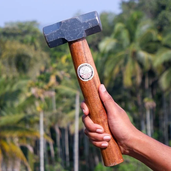

Maybe chuck one of these in your boot for next time it decides to play up ....
I'd pull that starter and check/test it and replace/rebuild if required.
