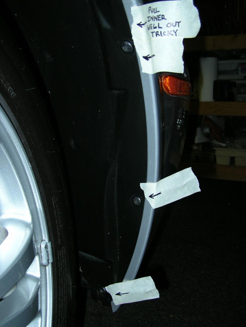

Difficulty level: novice
Tools needed: T30 torx bit, 10mm wrench, 10mm socket, rachet with atleast a 12" extension, some type of tape.
Time: less than a half hour
-Remove 9-T30 torx screws from front bellypan (no need to remove the whole belly pan, as some would direct).
(sorry no pic)
-Remove 3-T30 torx screws from inner wheel well, each side. GENTLY pull inner well out around fender lip (note in photo "tricky" there is a 6m (10mm wrench) bolt inside, very tight area).
-Disconnect blinker, fog lamp (if equipped) harness, location is inside drivers side bumper skin behind blinker (US model)
-Remove radiator splash shield
-Remove 4-6m (10mm socket) bolts from upper headlamp assembly including grill bolt (note upper right corner photo "down there" yet another "tricky" bolt, removal is quite easy), No "man hands" are going to fit to put bolt(s) back in. Use tape to secure bolt to socket for installation.
-Grasp lower grill opening and gently pull out then up, mine I had to wiggle a bit.
-Installation reverse procedure
*If you are removing headlamp assembly there are another 4-6m (10mm socket) bolts located underneath the headlamp assembly, visable after the bumper skin is removed. Disconnect lamp wiring harness.

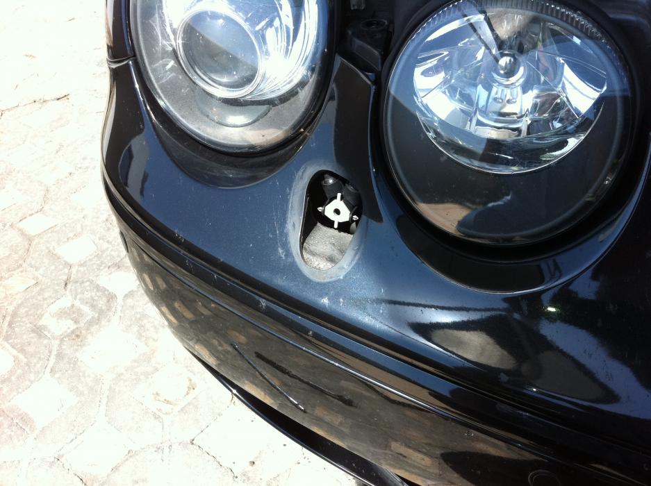

Default Need some help here
I'm actually in the middle of doing this operation to switch my HIDs.
However, this does not explain how do I remove the headlight washer covers without breaking them. I already started by breaking one of them, and would like to avoid breaking the second one.
Can anybody advise?

Done deal, I can advise this is done by having a helper operate the washer and, as it pops out you have to hold it with your hands.
Then gently remove the plastic cover.
