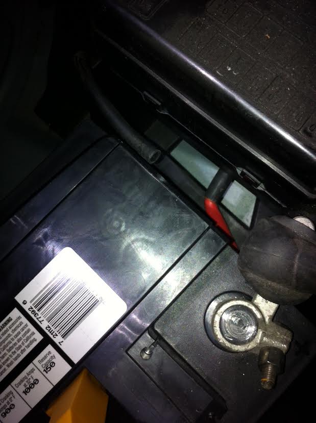

Well fellas came back with bad news, purchased a new battery ($180 ) and it didn't resolve the issues and created a very small problem while switching out the batteries. The little hose that's connected to the battery had a small 90 degree angled plastic thing that was connected to the side of the battery and the other end to the small hose, broke and is now a small piece is stuck inside the small port on the side of the battery. Can someone please tell me what that small 90 degree plastic piece is called so I can go out tomorrow and purchase one?
Also as I was swapping out the batteries I noticed their was a connector that wasn't connected to anything...right on top of the battery, I'm not sure if that's supposed to be connected somewhere or not..hopefully someone knows. Will provide an image tomorrow as well.
Thanks

The small 90 degree plastic connecter that goes on that hose.

I had the same problem when I replaced my battery. The auto parts store had some plastic hose connectors that worked for me.

Battery vent hose / connector, I guess.
Make sure that connector cannot short to anything but it should be unused.
