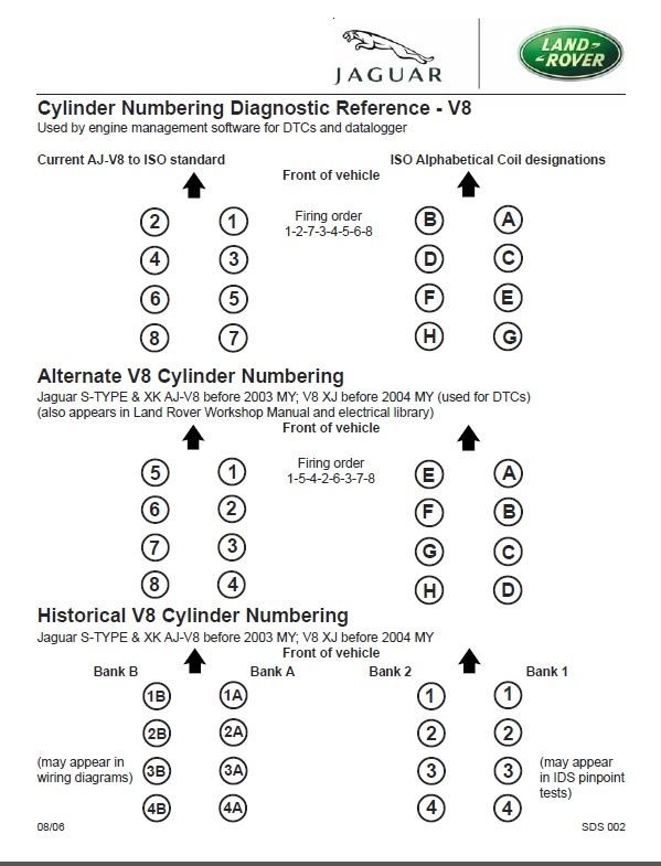

1. Cylinder arrangement... I found a diagram online that shows the cylinder numbers for up-to and after 2002.5 MY. This shows the cylinder numbers starting at the front, alternating from left to right (when looking at the front of the engine) with one the front-most left, two being the front-most right, three being behind one, and so on. I wanted to confirm this is correct, as I'm going to be replacing the coil packs for cylinders 4 and 5 to remedy a misfire.

This may be helpful, the cylinder diagram mentioned in the original post:
Old Mar 16, 2022 | 04:09 AM
Welcome to the forums Projekt-H,
Jaguar V8 cylinder numbering is even more complicated than that!
The only consistency throughout the years is indicating which end of the engine is the front.

The firing order works out the same, too, I think
