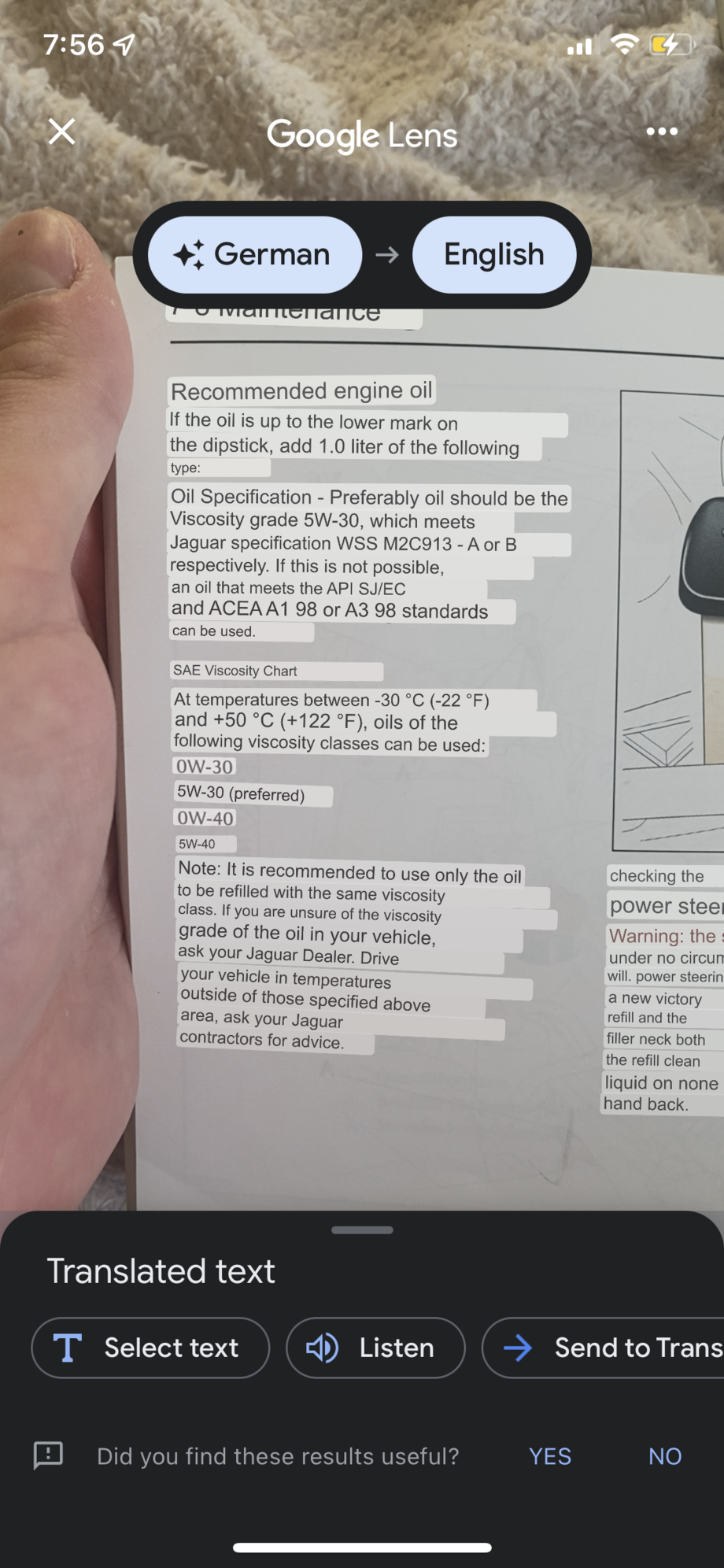

FORD WSS M2C913-A or B (C and D are newer compatible versions) is the oil spec/approval you are looking for. modern oils have detergents too, very good to prevent slushing
