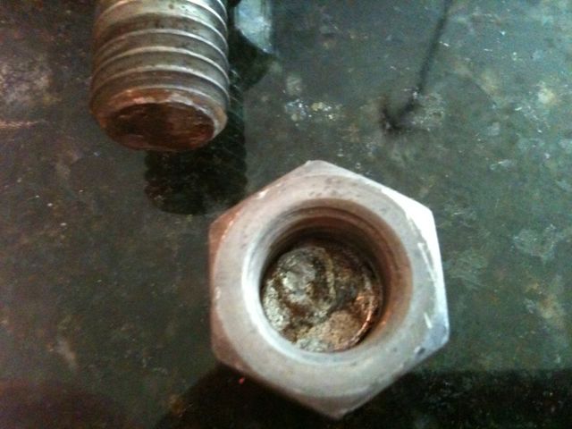

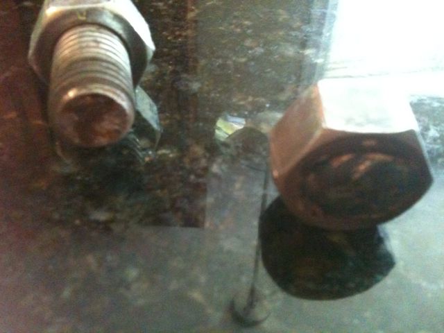

The puller I purchased failed due to a weld failure (see pics). I was sent a replacement UPS next day. Below are a some emails...
Mike,
Received! I appreciate your quick response to the weld failure!
The new welded nut and threaded rod worked perfectly. It took less than two minutes and I was able to press the small pulley on the rest of the way.
Sincerely,
Bryan
sales@eurotoysltd.com
Jun 20
to me
Hi Bryan,
I am glad that you finished it. I will re-write the tool instructions to be more specific, have been meaning to do that for awhile now. I contacted the tool maker and they said they have had 3 break in 10 years, and 2 has been in the last month. They changed who welded them, go figure.
Mike
Eurotoys Ltd.
847-464-4000
Attached Thumbnails 3 lb. pulley install problems-weldfailure1.jpg   3 lb. pulley install problems-weldfailure2.jpg

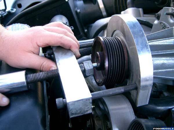

Is this the puller you used??
Attached Thumbnails 3 lb. pulley install problems-super-charger-pulley-removal-tool.jpg
Yep, that looks like the one.
