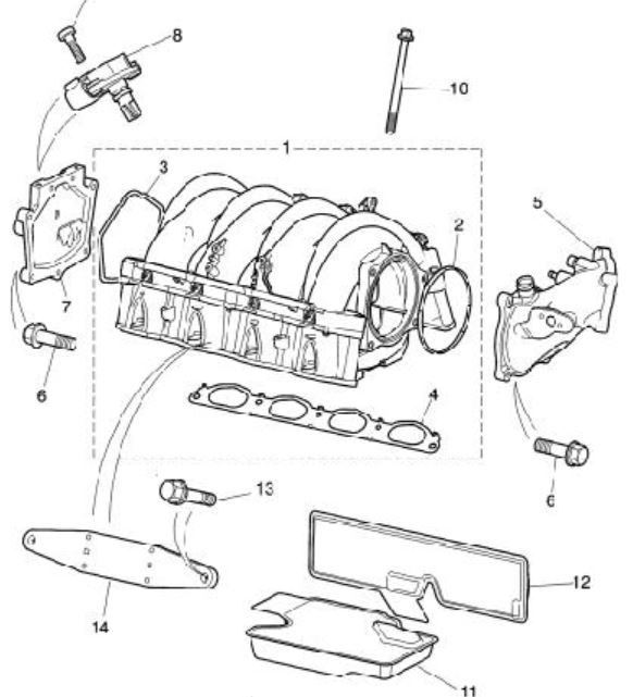

Here is what JPART shows;
What number are you looking for?
#2,3 and 4 are listed as gaskets.

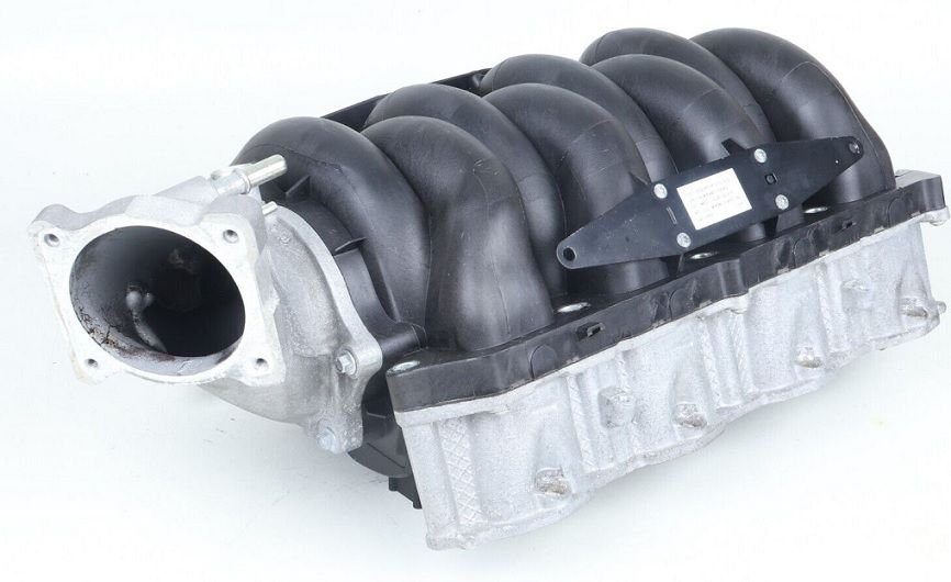

Cobbler I have been thinking about your question?
It appears there is another part that comes off and it has a gasket (I think?). And yes Jaguar does not list it and you can see that from what I posted above from JPART.
Here is the assembly as it sits on the engine. Gives a good view of the two piece intake manifold.

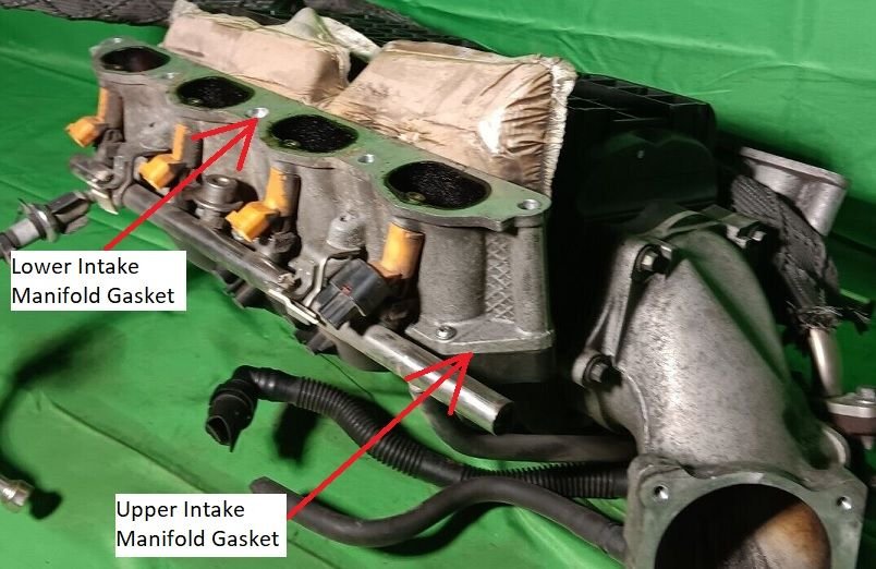

Here is another picture of the intake and I have labeled the two gaskets sets we are talking about.
Now Jaguar ONLY lists the "Lower" intake gaskets as I have labeled in the above picture.
In the above picture I have labeled the "Upper" intake manifold gaskets which Jaguar does NOT offer! Yea why I don't know?
Here is that separate lower intake manifold piece.
The lower intake manifold gaskets look like this. This is the gasket between the head and the intake metal surfaces. Jaguar part numbers MS 96923, AJ89062, 4628235.

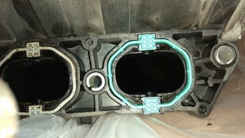

Now we got lucky as there are a number of after market suppliers of the upper intake gaskets. But there is some confusion about exactly what they look like. So again you need to get a picture of the upper gaskets so we can compare them. I have seen several different styles for sale on EBay.
Here is the plastic part of the intake manifold with the gasket in place to help show what you need to find out.
Here is a set for sale. These are NOT Jaguar produced parts.
Upper Intake Gaskets
If you can get the information needed we can see what to order.

From all the research I've dome the past few days, it seems the 2003 4.2L could have had two different plenum to riser gaskets, like this link you attached in your first reply 4.2L NA Intake Gaskets The green ones at the bottom of this link are the ONLY ones Jagbits offers and the orange ones are nowhere to be found from I researched. So, if there are two different ones for the 2003 4.2 why does Jagbits only offer one style, that's what keeps me from buying them. Sure would hate to buy those from England only to take it apart and find I nee the orange ones.
Reply 0
Mar 5, 2025 | 12:34 PM
Okay, I just got off the phone with TJ from Jagbits, which is NOT in England but Michigan with warehouses throughout the US, and he said the green gasket with the black square, like in the link provided 4.2L NA Intake Gaskets bottom pic is for 2003 thru 2008 S-Type 4.2L. They are NOT a Jaguar OEM part and he did not know who makes them but for the many he has sold he has never had and complaints. So I feel this https://www.jagbits.com/product/PLENUMSEAL-KIT.html is the best way to go for my issue. Thoughts?
