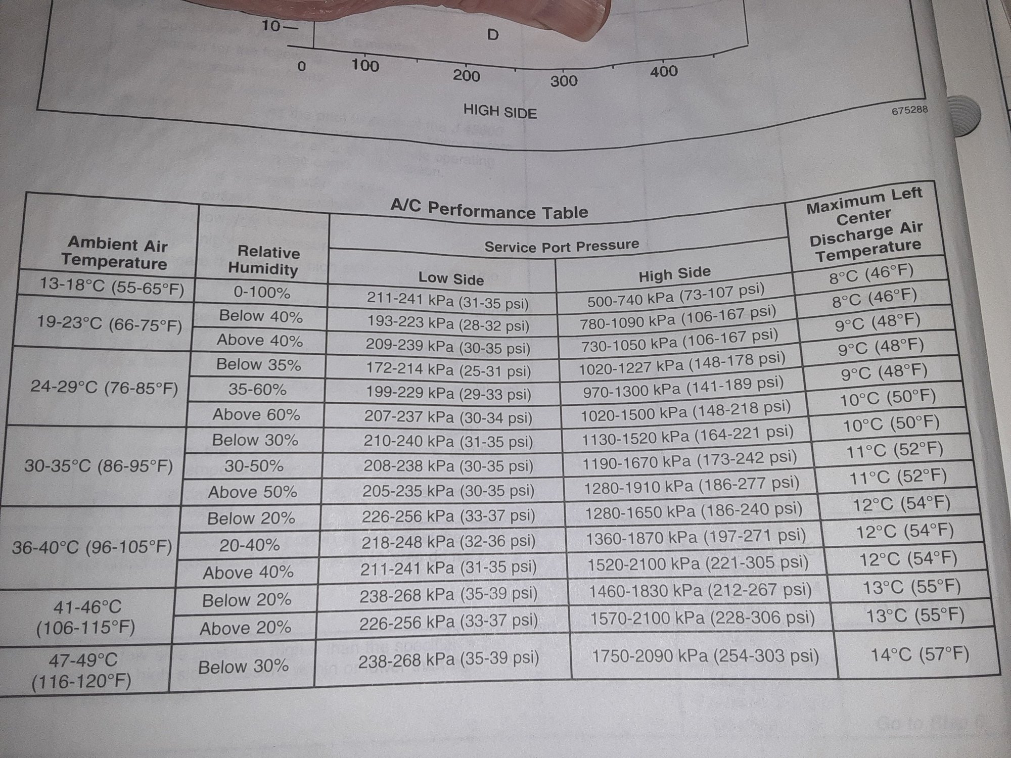

Hello Karl,
The repair manual for my 2002 Corvette specs a vent temp of 50 to 52F at an outside temp of 86F (see chart below) so I though my Jag vent temp of 65F was not too bad for a quick fix. I do not have the specs for the Jag ac vent temp but you said it should be 38F. Where did you get this data from?
Howard

Originally Posted by hak
Hello Karl,
Howard
Wow, those Corvette specs strike me as somewhat pathetic. Seems to have a poorly designed system. Are those numbers specified with the vehicle not in motion, and thus minimum airflow (fan only) through the condenser? I would certainly hope any car could do better than that at freeway speeds, but if that's what Chevrolet says was good...
As far as Jaguar, I don't have any actual specs. In fact, I've never really looked but I'm sure they are out there. The 38F value I gave was based solely on my experience with my S-Type and other vehicles. That seems to be the value the designers aim for, to keep the evaporator from icing up. 38F seems to be the ideal margin above freezing for best AC performance, but without ice accumulation. This 38F setting isn't adjustable on our cars. My old pickup (1984 Ford, converted to R134a) is another story, and it uses an adjustable pressure switch to control evaporator temperature. I've experimented with that and if I get the duct temperature below 38F, the evaporator will slowly ice up and cooling output decreases. When the switch is adjusted to maintain 38F output, the cabin gets colder than Nancy Pelosi's heart.
I've done nothing special with the AC system in my S-Type, and it will freeze you out of the cabin even on the hottest days. I sure wouldn't settle for 65F.
I should also mention I keep that little pocket thermometer in the vent at all times. This helps me keep an eye on AC performance. When I see the needle down around 40F, I know all is good. If it creeps up, then I know the system may need some love. If the vent temperature was up around 50F (when commanded cooler), it would still feel cold and so I might miss this early warning. I might not be able to discern that difference, but the thermometer sure can.
