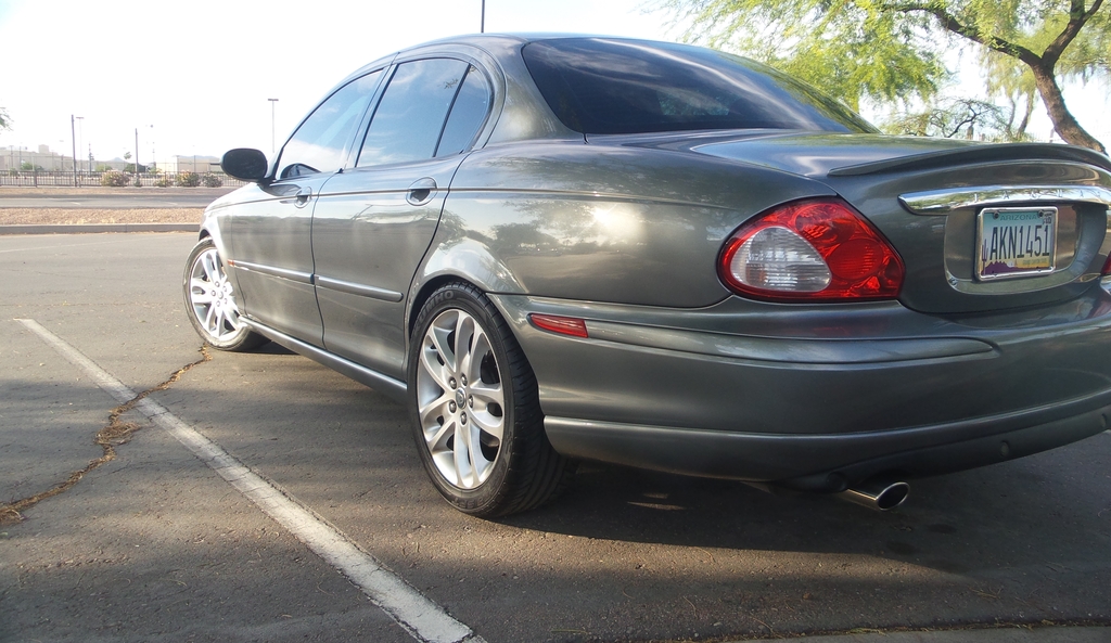

I'll be putting a new AC compressor in this week. On my way to Tucson Saturday the temperature was a sweet 110 Fahrenheit. My AC died on the hwy and is totally dead now.
It's the clutch mechanism on the compressor that locked up or broke loose. When I engage it, nothing happens. I imagine these are original parts, I'll be sure to check as I've had this car 5 years of its 13.
The pulley for the compressor turns so the serpentine belt is humming along. The motor makes a stupid chingering noise now which makes me look like a derelict Jag owner when I start it up in public.
I'll have to find a good AC shop to replace the AC compressor and recharge the system, check for leaks, and put a bow on it.
