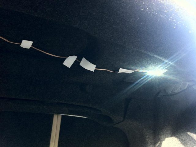

I'm not used to having a car with a trunk as big as an S-Type's. Fantastic, love the spacious trunk interior. Problem is at night time, light only extends to the area that runs the length of the trunk lid. Because the trunk light is attached to the back / top of the trunk lid, no light reaches items in the rear of the trunk. This was a huge problem as I had forgotten cold groceries in back of the trunk at night because it looked like I had gotten everything. Yeah, no more.

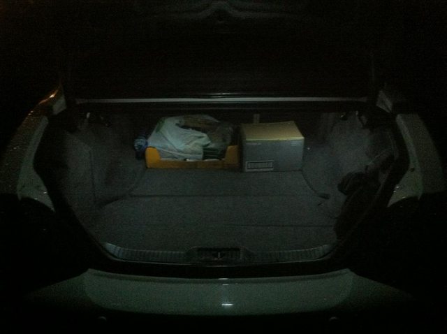

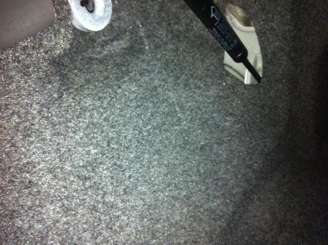

I took some of the x3 LED pure white strip lights, the same kind I used for the interior, and used them for the trunk. I tested out a couple different configurations and found that two LED lights were the right lighting.
I wired them up with the same wiring as I did with the interior; small-gage speaker wire. I wired them up to the trunk light's power source, of course. There's a lotta' ways I could have fastened the wiring, but I decided to make use of the fabric roof and just use Velcro strips to keep the lights and wires in position. The wires can't be seen unless you crane your head.
Next I needed to get the trunk light's light to match the color and intensity of the LED's. Rather than buying a LED bulb online and questioning its temperature and brightness, I decided to hook up one of the strip LED's and use it in place of the stock light fixture. Same temperature, same brightness.

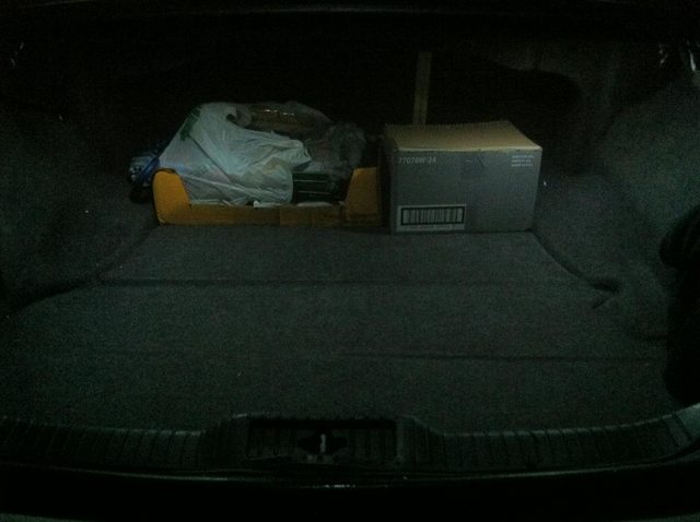

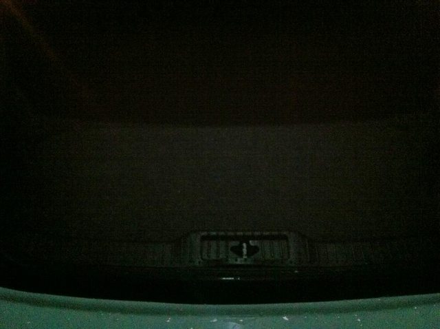

You see the trunk at night. Here's the trunk with only the trunk light (one strip LED) on and the rear LED's off. You can't see what's in the rear of the trunk at all. Then, with the rear LED's on, you can clearly see all parts of the trunk equally.

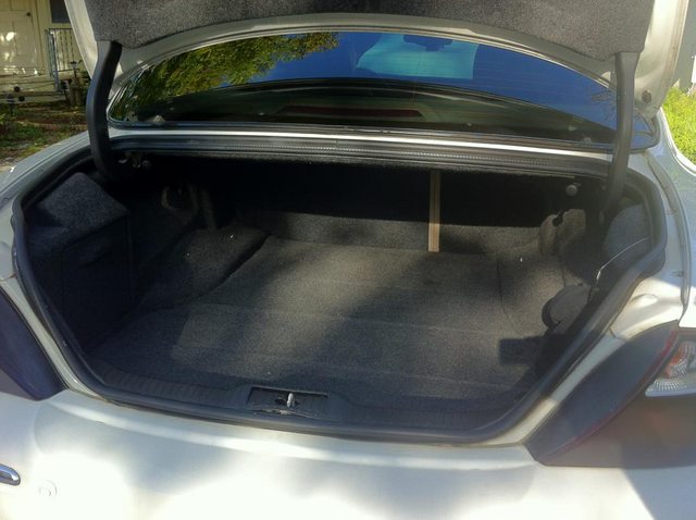

Would one of you 2000 S-Typ owners be so kind as to grace us with a photo?
So, to answer the 2000 S-Type owners, this is why I created this modification because there IS only one stock light for my car (a 2004 S-Type). And the position of the second light in older S-Types isn't ideal. My Lexus SC400 had a light on the side in the trunk in the same way and it sucked, anything large placed on the side of the truck blocked light from reaching the other side. Thus, I added two lights positioned on top of the Lexus (the best position for trunk lights), just like I've done for the Jaguar.
And as far as the wiring, look at the very first picture posted. I fastened the wire the way I did because one; it works and is removable without modifying the interior and because two; it can't be seen at all unless you bend over, stick your head in the trunk and crane your neck up. I've had these lights in the trunk for over two months, including several "trunk filled to the roof" loads and not one issue. In the first picture, do you see any wires? Do any of you see any "Christmas tree light string hanging every which way"?
