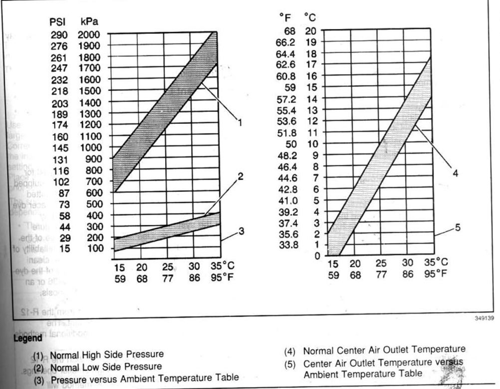

You have two switches. You are working on the low pressure switch. It prevents the A/C clutch from engaging unless there is enough pressure in the A/C system. From your description you are low on gas. If the compressor kicks in when you have the jumper in place then the switch is bad (not too likely but can happen) or most likely just too low a pressure.
You also have a high pressure switch but it vents the excessive pressure to the atmosphere and does not control the compressor. Sometimes called a blow off valve or pressure relief valve. The few times I have had one release it sounded like something exploded under the hood!
Please post what the high side and low side pressures are when the car is running. Also the outside temperature and the air temperature coming out of the vents in the dash. The gauge pressures will change with any change in Freon levels (Under filled or over filled) or temperature required. So there is a range of pressures that can be expected.
If you look in the shop manual they generally print a chart with acceptable ranges. Here is one but I am sorry it is not for the S Type. I don't have the shop manual with me right now.

I have an appt. in about a hour to get the system checked for a leak and to have it recharged. I figure it is pointless to troubleshoot further until I get the system charged correctly and also that will stop me from causing furtehr damage. I'm really hoping its just low on freon. Not knowing much about AC units I think I have over complicated the orginal issue. Not to forget to mention the mechanic that did work on it with the last owner caused many of the problems. But I cant complain because I got the car for a steal of a price and after replacing the battery with the correct size battery, fixing the gas tank seals and the AC I will have perfectly running Jag. I will let you know what happens after I get my car back today.
