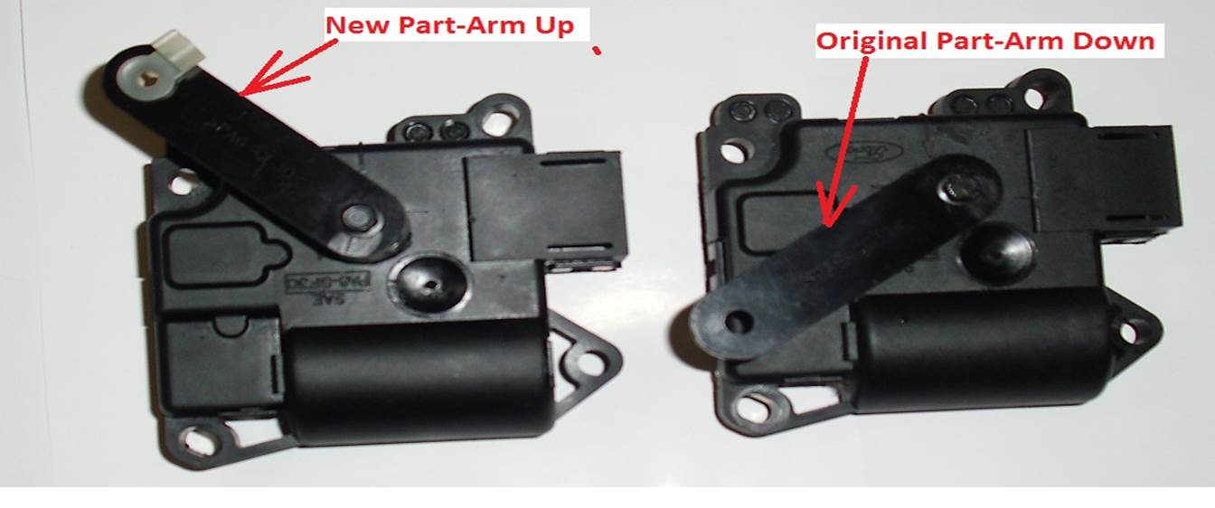

On my 2005 STR I started getting a low tap, tap type noise from behind the dash. Only happens after the car is driven a while and the climate control slows down as the passenger compartment temperatures come under control. Very low in volume and I have to turn the radio off to hear it.
I followed the noise and it's in the passenger foot well area. This matched well with the description above of the blend doors hunting for the proper position. The actuator is not too expensive at about $50. Jaguar made it dead easy to change too! Just remove the glove box and you are looking at the actuator. 2 screws and uplug the electrical plug and it's out.
I got part number XR8 57888 as posted above (all marked with Ford part numbers too) and it is the correct part but it was assembled wrong and the actuator arm is about 100 degrees out of alignment. I can get another actuator and I am currently returning the one I have.
But the weird part is I put the old one back in and it's been a week or so and no noise of any kind!!
Could removing and reinstalling the actuator somehow reset it's position? I did cycle the power with the actuator hanging free so I could watch what it does when it's not hooked up to a blend door with the steel rod.
