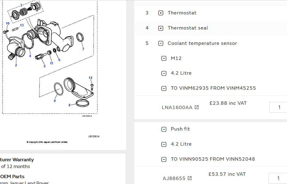

Hello,
which would be the correct ECT sensor to order for a 2006 (USA) S-Type V8 ? Thanks

Looks like this is your part:
https://www.britishparts.co.uk/class...ture-lna1600aa
https://www.aliexpress.com/item/1005...Cquery_from%3A
So: LNA1600AA

About that original question: AJ88655 or LNA1600AA?
Don is right - it's always a good idea to double check on
parts.jaguarlandroverclassic.com
However, strangely enough, you'll find:
https://parts.jaguarlandroverclassic...re-sensor.html
and
...and for both P/Ns this site will tell you: S-type 1999 - 2008 Classic
i.e. to VIN restriction.
I understand that both sensors look different.
Thus, in this case, it might be best to actually remove the part first to look at it before ordering.
Which is what I do always wherever practicable.

-Correct on the part# both fit the S-type, in all jaguar sites. Once you order, then you will be notified of the correct part# to use.
