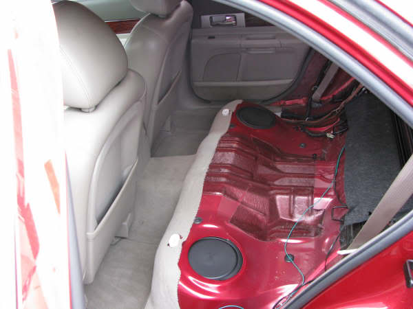

Yes get access from the top. We are lucky that Jaguar gave us these access ports as they are bunch easier than dropping the tank.
BUT be aware that the top big round connections are easy to damage and call for as special tool to remove them. You most likely have a seal leak in the top cover. The covers have cracked before too. I just hope the shop won't cause more damage to the delicate plastic caps and seals.

If you are interested a forum member has made a home made tool out of a large diameter plastic pipe. He cut slits up the sides to match the fins on the plastic caps. Others have used a hammer and a punch (Carefully!) to tap the cover and unscrew it.
Here is a picture of the fuel tank access ports. It's a Lincoln LS but the cars are the same under the skin.
