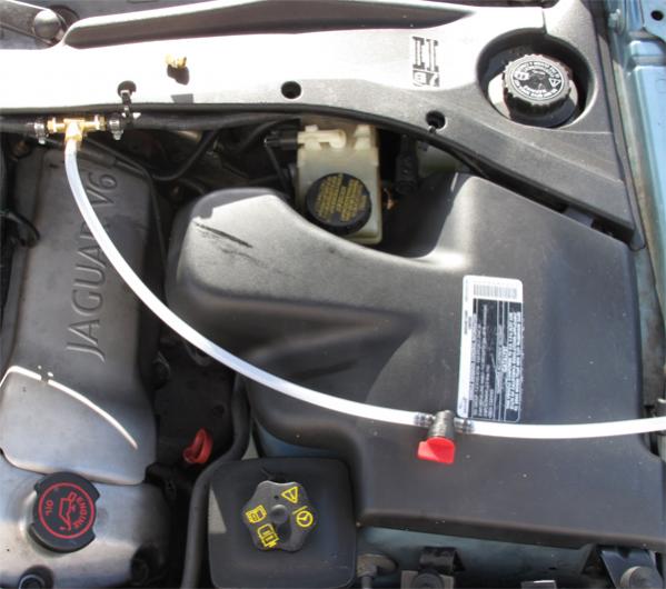

Several people have mentioned that their vehicle does not have a heater bleeding valve and have asked for a simple way to bleed the system without using the heater bleeding valve. I have used the following modification, and it appears to work. It is based on a modification of the main coolant system bleeding valve, which I posted here:
https://www.jaguarforums.com/forum/s...solved-108429/
This change requires two additional parts which should be available at any decent hardware store.
1 ea. Brass barb fitting 1/4 inch ID x 1/4 inch MIP
1 ea. fuel valve for a lawnmower
Install the modification as shown in the following photo.
After installing the modification, you should close the red fuel valve. Fill the reservoir with coolant and replace the cap. Start the engine and allow it to reach operating temperature. Open the fuel valve, and coolant and trapped air should flow out of the tube. When the catch bottle is almost full, close the red fuel valve and pour the coolant back into the reservoir. Add additional coolant as necessary. Repeat this process until air no longer flows from the system. Close the red fuel valve again. Bring the engine up to about 2000 - 2500 rpm and hold it there for a couple of minutes. Let the engine drop back to idle and open the red fuel valve again. Repeat this process until all of the air is removed from the system. Once the air is out of the system, turn the engine off. Open the reservoir cap to release any pressure in the system. Replace this modification with the original brass plug. Fill the reservoir with coolant and replace the cap.
