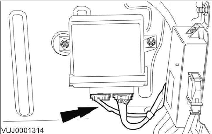

I want to replace my stock CATS struts (front and rear), the active ones are really expensive and I think I can live without them. After some research found this device that promise get rid of electronic struts without the annoying messages and errors. Does anybody have any experience with such devices (I've been checking deep in the forum without any luck) or maybe just a 25watt 3.9-ohm resistor (as I found somewhere else) is enough?
manufacturer link to the product: APDTY APDTY 27389 ELECTRONIC SUSPENSION BYPASS 27389 | Auto Parts Direct To You
a reseller with a little more information: https://www.aghanimarket.com/index.p...ducts_id=89177
some extra information: http://www.monroe.com/downloads/inst...M01154RevA.pdf
... or just unplug the control module ?
