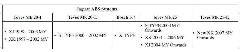

Maybe this will help.
Cheers,

Great input!
I thought it might be based on a MK20, but the standard MK20's main body has dimensions of 43mm X 101mm X100mm, where as my 2000 S-type ATE module has dimensions of 43mm X 110mm X 135mm.
Perhaps the "E" designation includes the DSC/TC features, so the module is larger?
