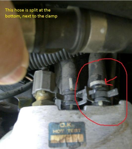

I've developed a good leak. I even bought a pressure tester and found it myself (yeah I know...Big Trickle)... but I am not very mechanicaly inclined, so for me it's a partial "Wooppiee!!.. The attached picture show the hose...I don't have one of those programs where you can do all that fancy pointing n' such. But it's hulighted by my mini-mag light. There are two hoses there side by side. This one is on the right (facing engine) and circles around to the side of the expansion tank. The other goes back between the left side SC box and intake and heads off towards the firewall. Now...The big question...could someone please give me a number for that hose? or possibly the name please. I'd sure like to get Kitty up n' Runnin'
Thanks
Fast Freddie

At Last!!... Took me the better part of an hour...but I finally got these stinkers to stick...I hope they show the hose better. Does anyone have the proper name or number??...

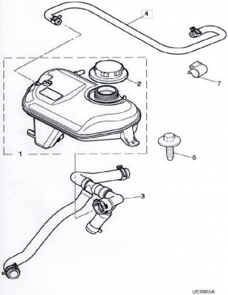

Well... I think I found the part (see attached) But wouldn't you know, the only number it gives is C2C10871 That doesn't seem to be the part number. But downoading the JEPC was worth the Tap Dancing I had to do. In this case...it worked better that the JTIS. It's part Number 4
Drive On!!...

That's a plausible part # (many start C2C) - can't say it's really right but it's at least plausible

That is a good part number but be aware the last 6 digits of your VIN are VERY important. I also have a 2005 STR and have replaced several hoses in the area you have your leak. Change all the hoses you can. It's a snake pit and I had a second pin hole leak several months after the first and had to go in again to replace.
Call Dan at Nalley Jaguar to get parts. 15% discount and usually free shipping. Get ALL the parts before tearing it down.
