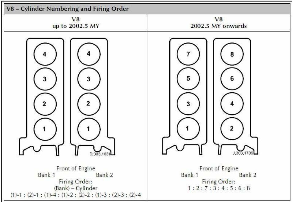

Just got back from Auto Zone, again, and they swear the driver's side ( left hand steering) is bank 1 and the passenger side is bank 2. Does Jaguar revers banks because of right hand drive in GB?
Old Mar 20, 2011 | 03:05 PM
JagV8's Avatar
Posts: 27,546
Likes: 4,923
From: Yorkshire, England
Jaguar use the international standard for your car. AutoZone are wrong. Bank 1 is always on the right, and you're driving an LHD car surely.
Old Mar 21, 2011 | 09:41 AM
Glendoramike's Avatar
Posts: 273
Likes: 75
From: California
If you are standing in front of the car looking at the engine, bank #1 is on the left. Here is what it looks like:
Attached Thumbnails Battery Disconect-jag%25204_0%2520cylinder%2520placement.jpg
