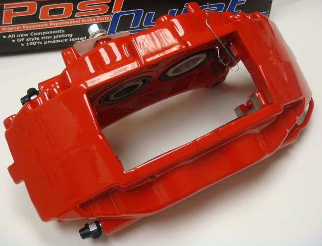

Yes you have two bleeders on each caliper. Check that they are facing forward on the front brakes. Straight up on the rears. Be sure and do them one at a time or you are only bleeding 2 of the 4 pistons.
See picture of front caliper below.
I just went out to my car to check, and you are definitely 100% correct! I've learned something new today; I don't think I've ever seen a caliper with 2 bleeders before. FJG123, just make sure the bleeders are on the top when installed.
