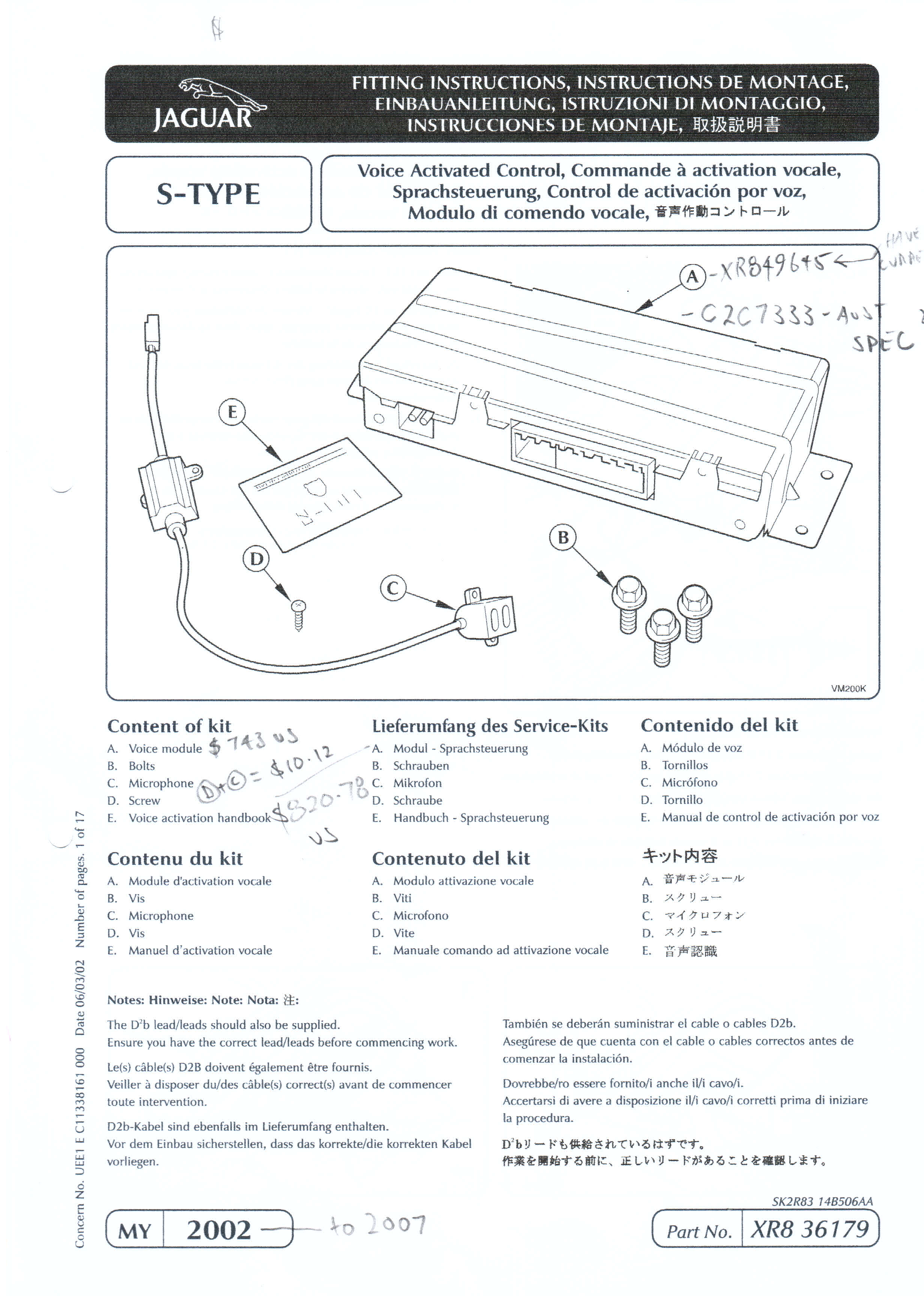

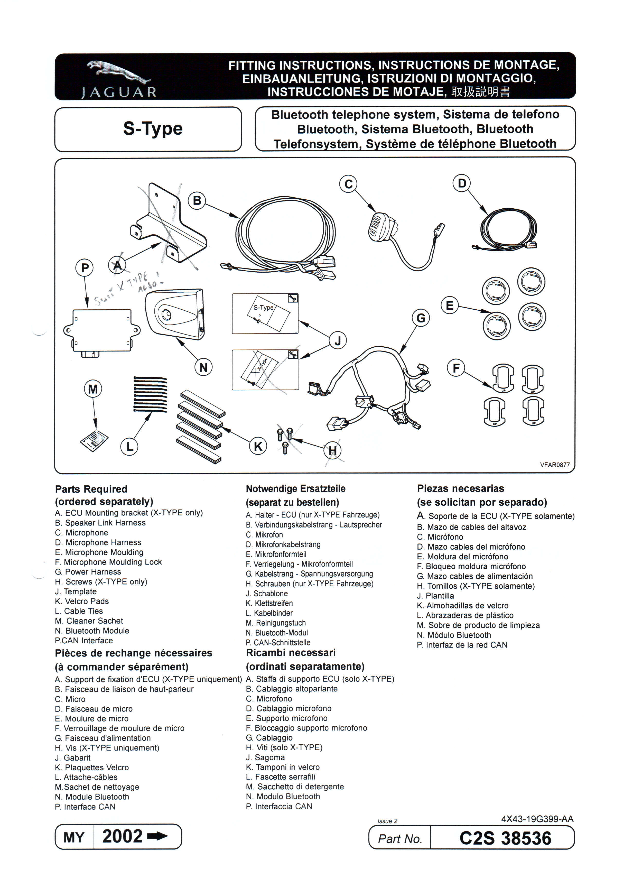

Have both these modules sitting in garage for 2003 STR. Question is-:
1. Neither module was supplied with microphone.
And Instruction for Bluetooth shows one type of microphone whereas instruction for Voice shows another?(See photos).
Bluetooth Module is C2C34515 for MY2005, VIN 41286
Voice Module is XR849645, for MY2002-2007.
2. Voice Module also listed as part no:C2C7333; for Australian market.
Should I have purchased this one, instead of the USA spec., (XR849645)?
And what is the difference between these two?
3. Also how does the earlier Bluetooth system kit available (for MY2002 onwards, C2S38536, with elaborate and complex looking installation proceedure), differ from the later one I have;C2C34515?
Any gurus please help!
thanks John.

As someone who has fitted all this to my 03 STR I can shed some light on this for you. If you have all the prewire hookups, the voice is easy, just plug the module in and hook up the mic in the overhead console in the car. Now, the reason you see two different mic setups is because of this: The one with the little disk looking mic is for a kit to setup bluetooth with voice control for car's that weren't prewired. I know this cause I originally had it in my car! I took it out once I realized I could use the fully integrated system since I was prewired. That stand alone system can't work with Jag voice, hence the two different mic setups. If you install the overhead mic with the voice system, the voice will work, but if you then install the stand alone bluetooth system, you will have two mic's and they will fight with eachother! Now, since all I have seen is these pictures, and not the actual parts, I may be wrong. But the bluetooth instructions and part list look exactly like the manual and instructions for the stand alone kit I had in my car. As a side note, it does work pretty well, as long as you don't have voice as well.

Chris, I think I understand what you have explained.
So since I have both Bluetooth and Voice modules to install, it appears I have to source the mic with the 2 little boxes; the one that fits in the actual overhead console rather than the one indicated in the bluetooth kit which mounts on the headlining.
Cheers John
ps. Still curious why there is a US spec(XR849645), AND an Australian spec (C2C7333), for what appears to be the same 'Voice Activated Control' unit?????
