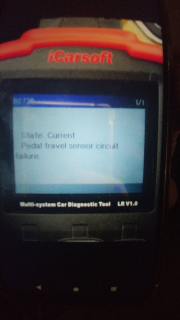

Got a code today whilst driving. Brake felt a little weird not sure if it's a bad caliper or what's going on.

Can you please post the 5 digit fault code? It’s going to be a single letter followed by 4 numbers. I’m unable to read it from the image you posted. Either the picture is too blurry or my Mom was right about what would happen to my eyesight.
Please be aware many scanners give inaccurate definitions for Jaguar specific codes. You can’t always trust the definition shown on the scanner.

B2736
Lol it was a picture of a picture so it's definitely blurry

As previously mentioned, B2376 appears to be related to the gas pedal, not the brakes.
Take a look in the workshop manual, near the bottom of this page:
JagRepair.com - Jaguar Repair Information Resource
Search the PDF for that code and you may find some details.
