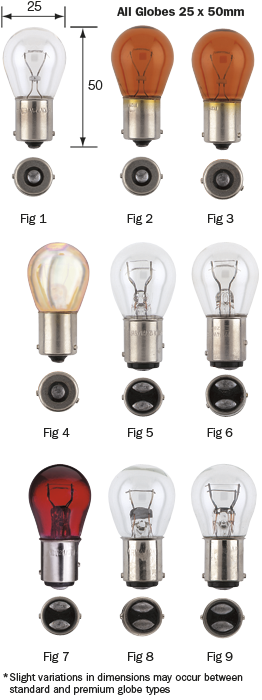

My Early S Type blew a bulb, as did yours, and since I have been in the Auto Parts Industry for 53 years, I simply grabbed a standard 12v 21/5W Offset pin bulb, and put it in. It went in, a tad tight, but with Plastic sockets, anything is possible. Worked for a while, then a bulb failure lamp, and since the X200 is so clever, it even told me which bulb, THE ONE I JUST DID, OOPS.
Thats when I found the bulbis "DIFFERENT" as has already be stated, and the pins are offset, BUT, also offset on the circumference when looked at from the bottom. Once I grabbed the correct bulb, and took note of the fitment "angle of the dangle" all sweet, and the Jag luvs me again.
I tried to get pictures of the difference that is SOOOOOO easy to mistake, but that failed miserably.
However, this image from the Narva catalogue might help???. The 2 different bulbs are #5 and #6, with #1 being the TOP left, and #4 being 2nd row, 1st left. Look at the base on the 2 bulbs, and the offset of the pins on the circumference is noted, and the bulb #6 is the one YOU need.
