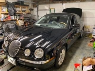

And oh my the way the reason the trunk is open is because of the battery charger.. Another thing if it wasn’t for my wife you fell in love with this piece of s%#t I would have sent it to the junk yard where this Ford Jaguar need to be. It might would be worth all of this bs if it was a real Jaguar but it’s a Ford on the inside where all the parts say Ford with a Jaguar and Jaguar’s name on the outside And its a shame Ford will not work on it and the only reason Jaguar does is because they are forced too...
