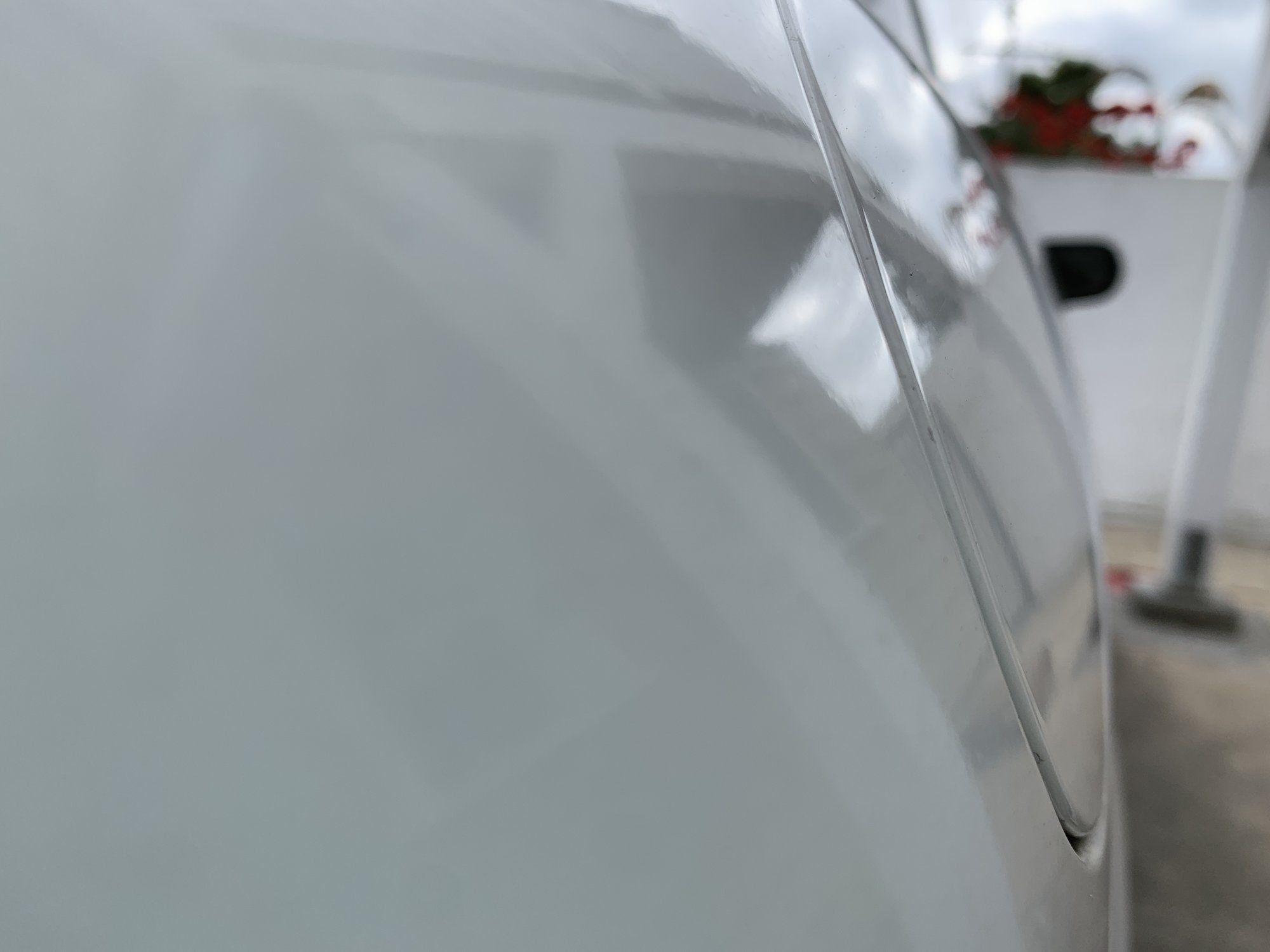

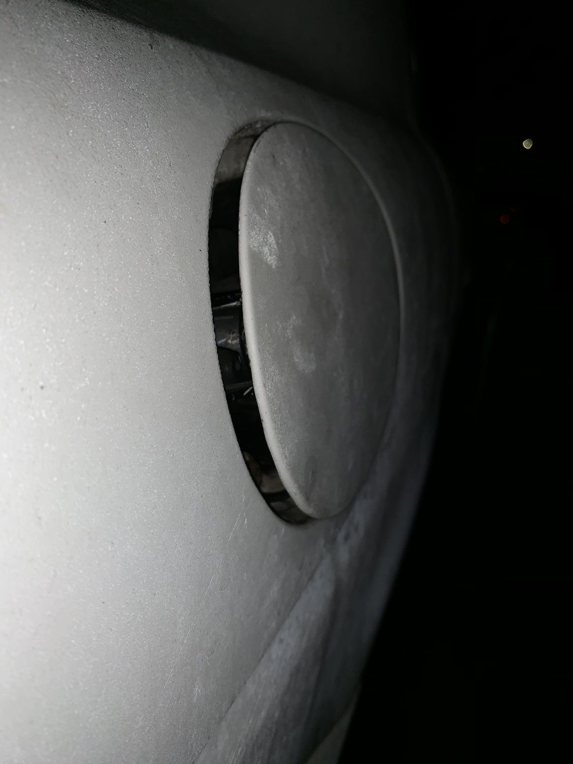

Gap before replacing striker

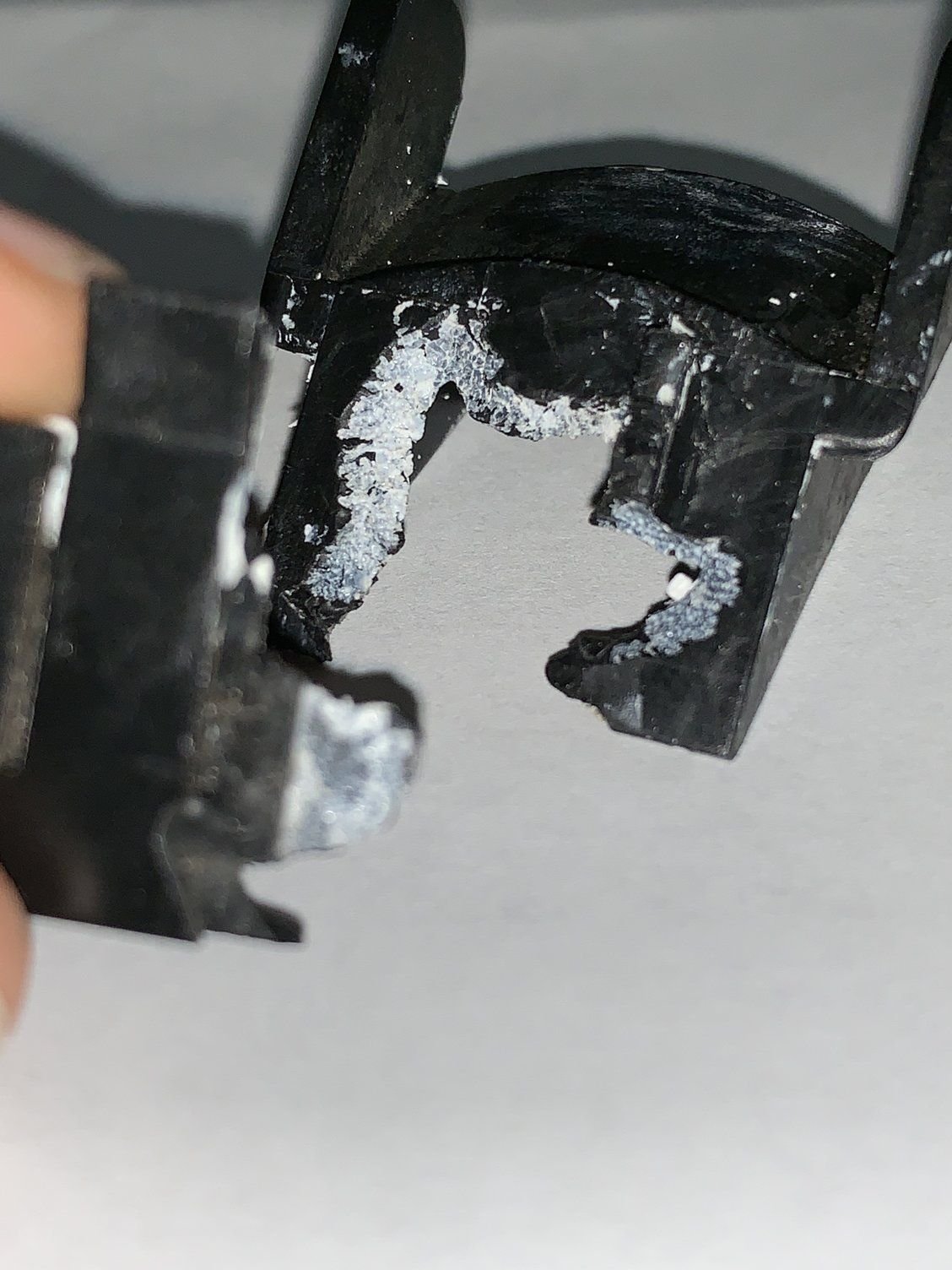

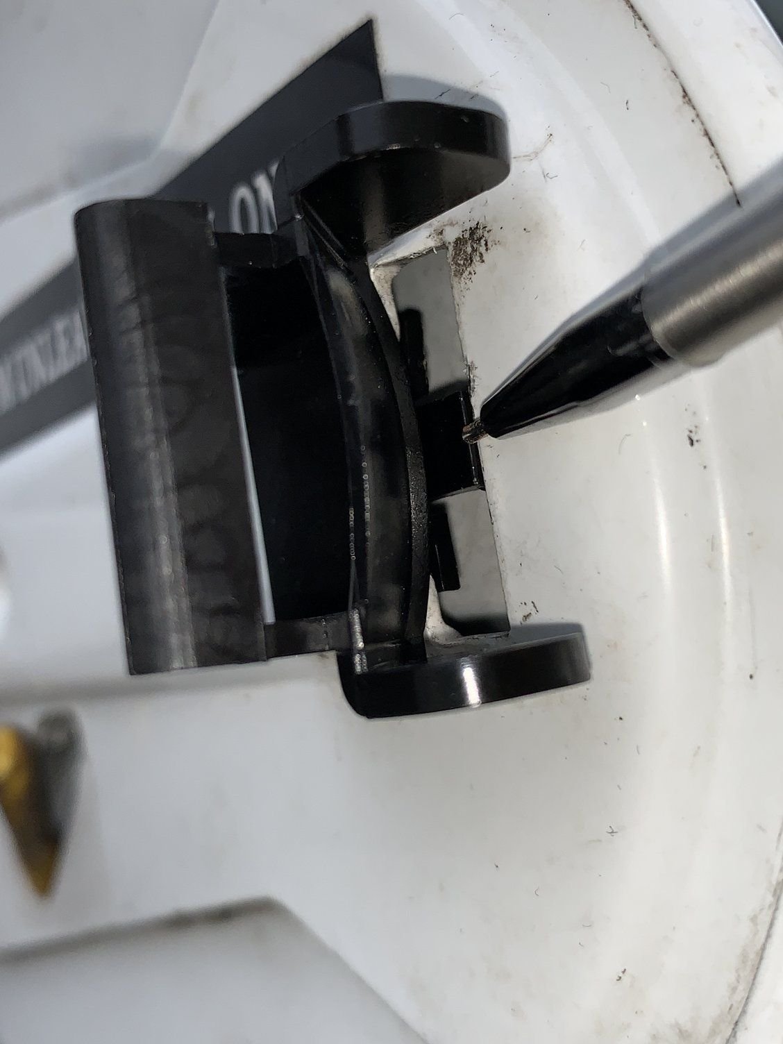

Broken striker on flap. The striker had broken and separated away so much, that it was too weak to hold the fuel flap flush, much less closed— it would open as soon as I started to drive. That white stuff is due to a failed glue attempt 🤦🏻‍♀️🤷🏻‍♀️

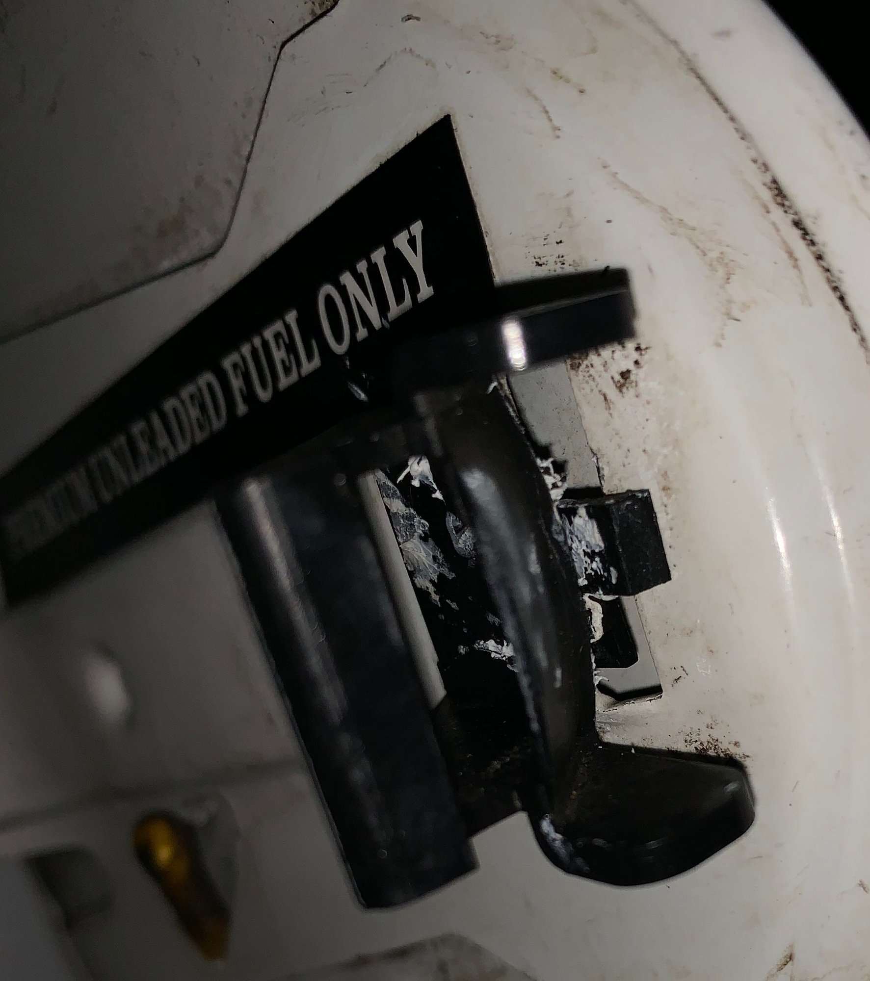

Note: before I removed the old striker, notice how the “tang” is sitting outside of that metal wall. I am wondering if it needs to be pushed in to sit behind it?

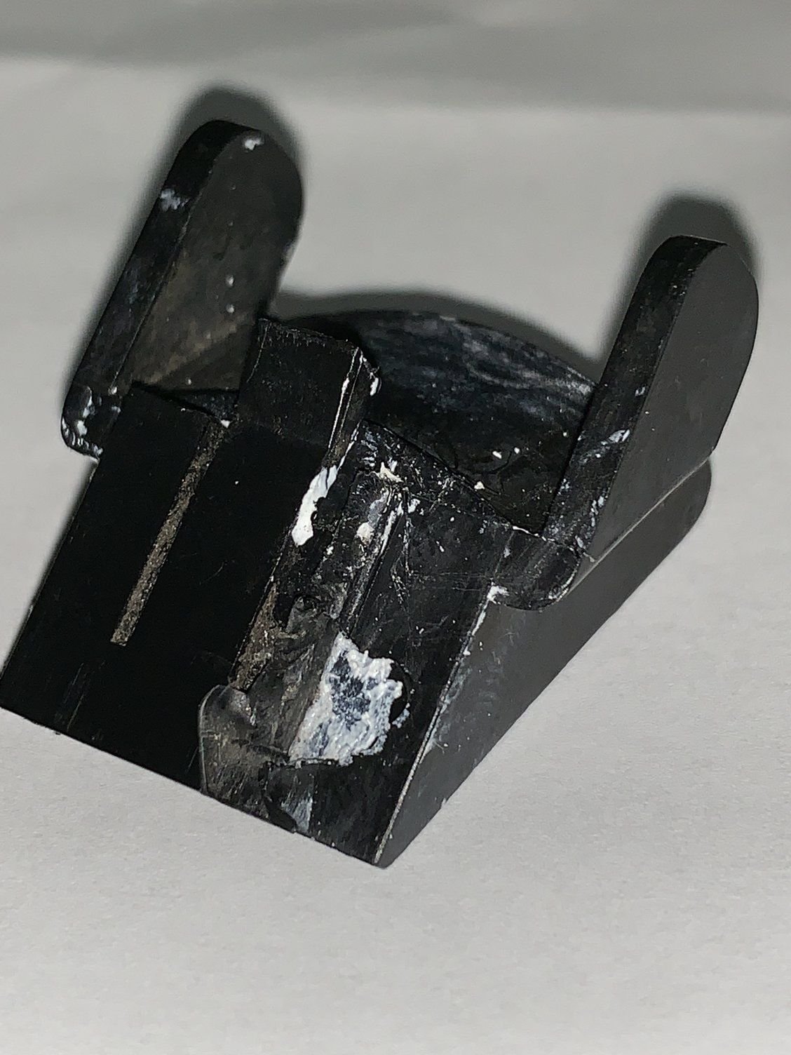

Broken striker (1 of 2) That tang in the center is what I have a question about.
Broken Striker (2 of 2) While removing it, it completely broke into 2 pieces. I realized that because it’s plastic, assume that all the pulling and catching eventually wears the plastic down. Then it starts to crack and separate where it clips on to the fuel flap.

3. Guided new striker in by aligning the grooves on the clip to the slot-rail on the metal notch. It was REALLY easy.
New striker on flap

In thinking that I had to “lock it in place” I began to push the tang all the way in thinking I would hear a click or something, but I stopped because I wasn’t sure and did not want to break the new piece. I went back to look at how the tang rested before I changed it (see picture #2). So, I do not know if the tang was resting outside that “white wall” because it was broken OR if in fact it is supposed to rest that way OR if it needs to be pushed into the space to lock/clip and rest behind the white wall.
I reiterate, I stopped myself from pushing it all the way in (see picture 6) and can still pull it out if I need to. Please advise!

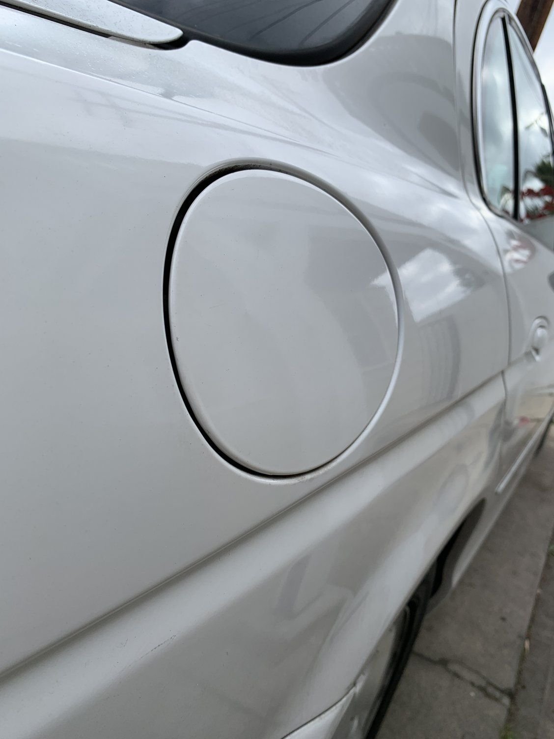

Here are some pics with the new striker installed
Even with the striker resting “as is,” look at how how NICE and FLUSH it holds the flap closed!
Beautifully flush 🥰😍

The tang looks to have correctly dropped into the rectangular cutout in the door which then keeps the striker in place.

Thank you for your reply! Just a note, it did not go all the way into the rectangular cut out(thanks for that terminology) it’s sitting flush, but I assume that is okay.

When I installed mine i placed white lithium grease on the grooves and the striker slipped into the void you pictured. I pushed it back to sit right on the edge as you have pictured.
Door closed perfect and flush.
End of the day you want a flush finish and you got it right where it needs to be.
