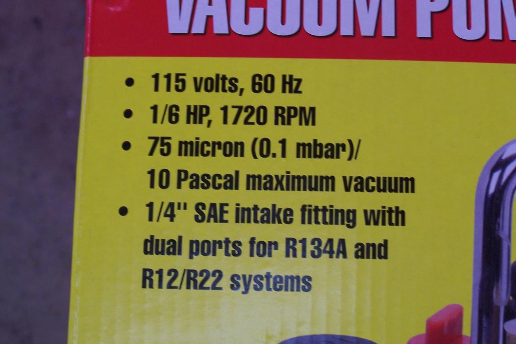

(Refurb) A/C Compressor with clutch = $102.00 Ebay same compressor as Lincoln LS
115VAC 2.5 CFM vacuum pump = $104.00 Harbor Freight A/C compressor 2001 3.0 swap DIY cost-100_8717.jpg
R134A Gauge set = $40.00 Harbor Freight A/C compressor 2001 3.0 swap DIY cost-100_8712.jpg
3 cans of freon approximately $60.00
Total cost to DIY approx $306.00. Vacuum pump and gauge set can be used on any car using R134 freon.
