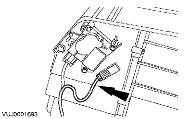

Where is this sensor located?

Is this it??

Is this sensor inside, near the key hole, or is it in the cooling system somewhere? Is there more than one Evaporator sensor?

driver side of the ac box about above your right thigh sitting it the seat. Its a white sensor and 2 wires. Pop it out with a small screwdriver to pop out of the case. The new 1 snaps in and reconnect the wire connector. I have changed 1 already today for a compressor short cycling. If you buy the new 1 youll easily identify it.
