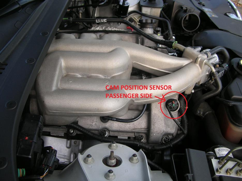

Does anyone know exactly where they are located on an 2000 S-type 3.0?

Here are pics of 2003 and up, I assume that the 2000 are the same. The valve covers have to come off to replace.

My engine looks a little different but I think I recall seeing something like that on the drivers side. I think you've given me a good starting point on what I'm looking for. Thanks!
