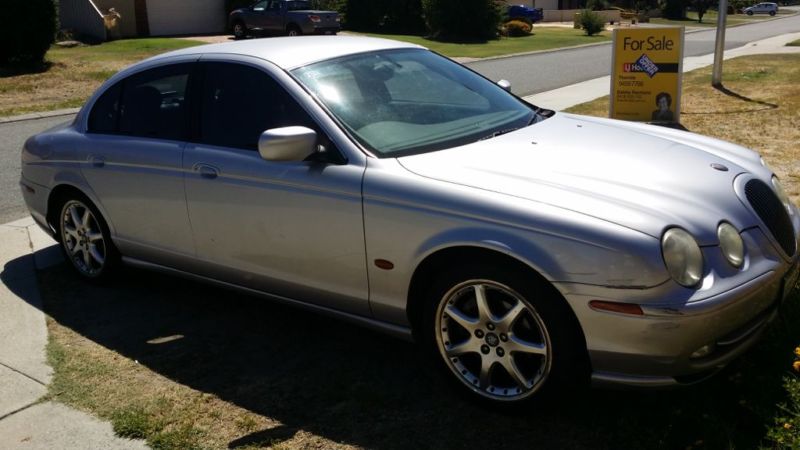

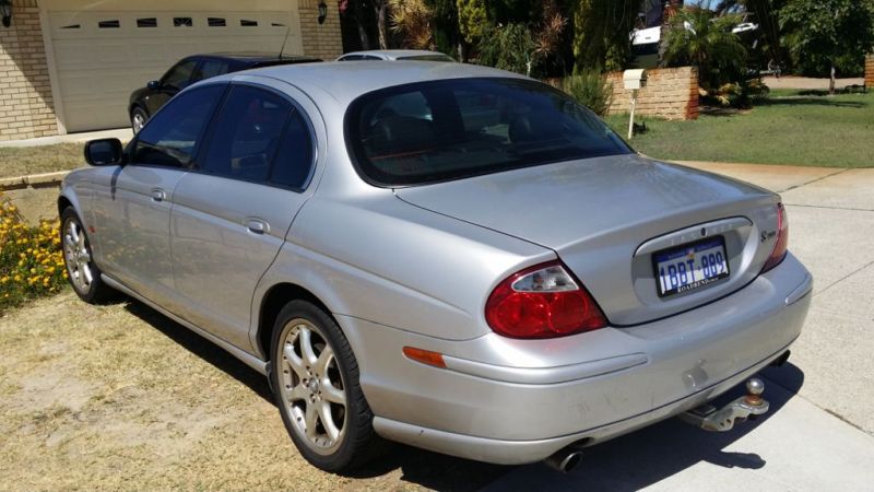

Here are the pics from the seller
Took a few weeks to get here, and when it arrived, well....disappointing...it's pretty rough...

First thing get rid of that towbar, it's a shin-smasher!

The towbar is definitely not a genuine Jaguar one, the wiring was the biggest hack job I ever saw, I ripped it all out yesterday when I had the battery out to clean the boot. a half dozen relays taped together & the wires tapped from the right rear tail light with scotch-loks.
The hitch will come out with a few bolts but it'll leave a big hole in the bumper, I found a near perfect bumper at a wrecker near Canberra in the same colour as this car, but it'll be pricey (as parts are in this country).
