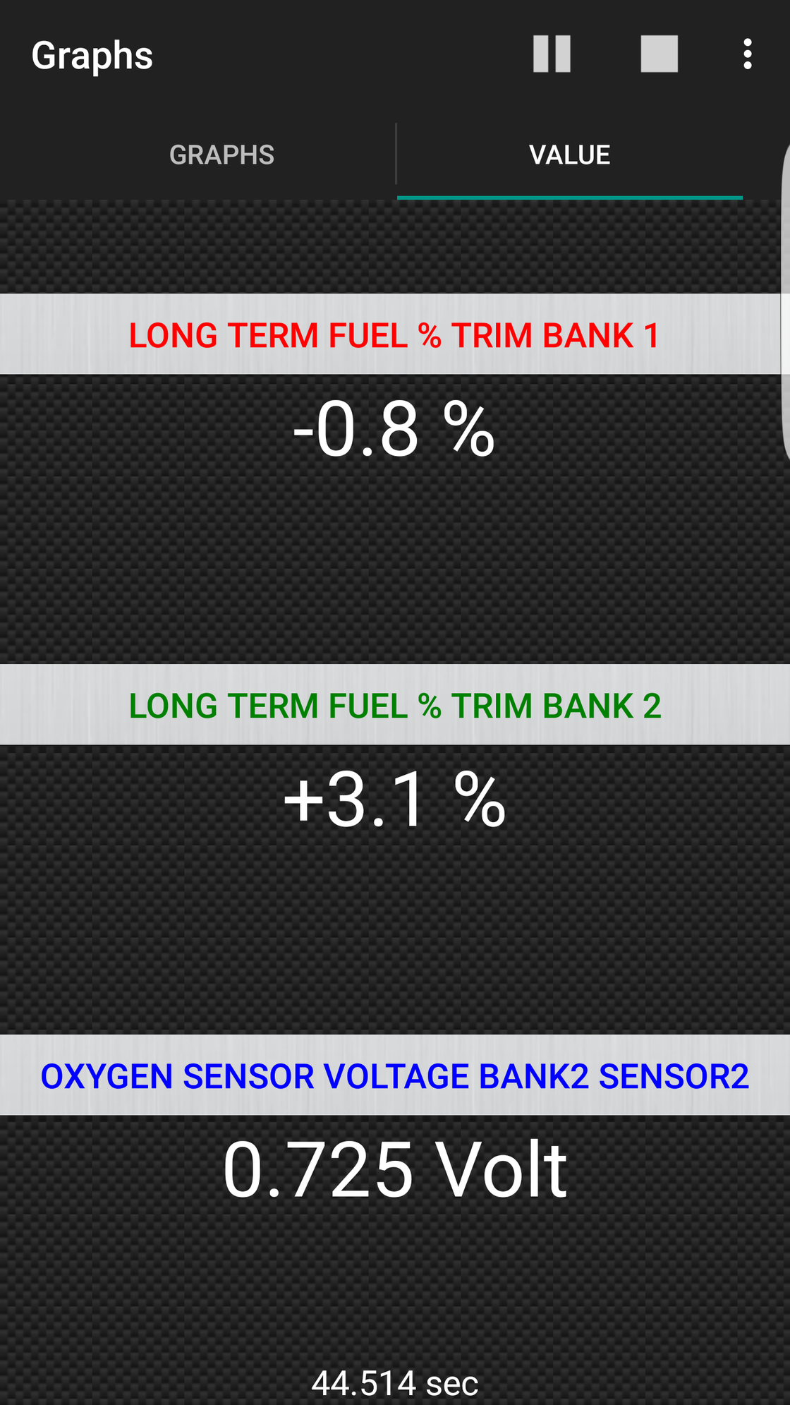

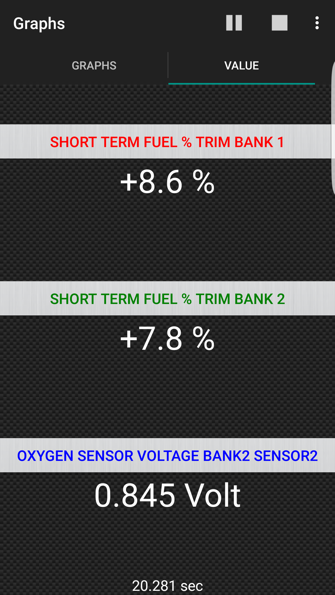

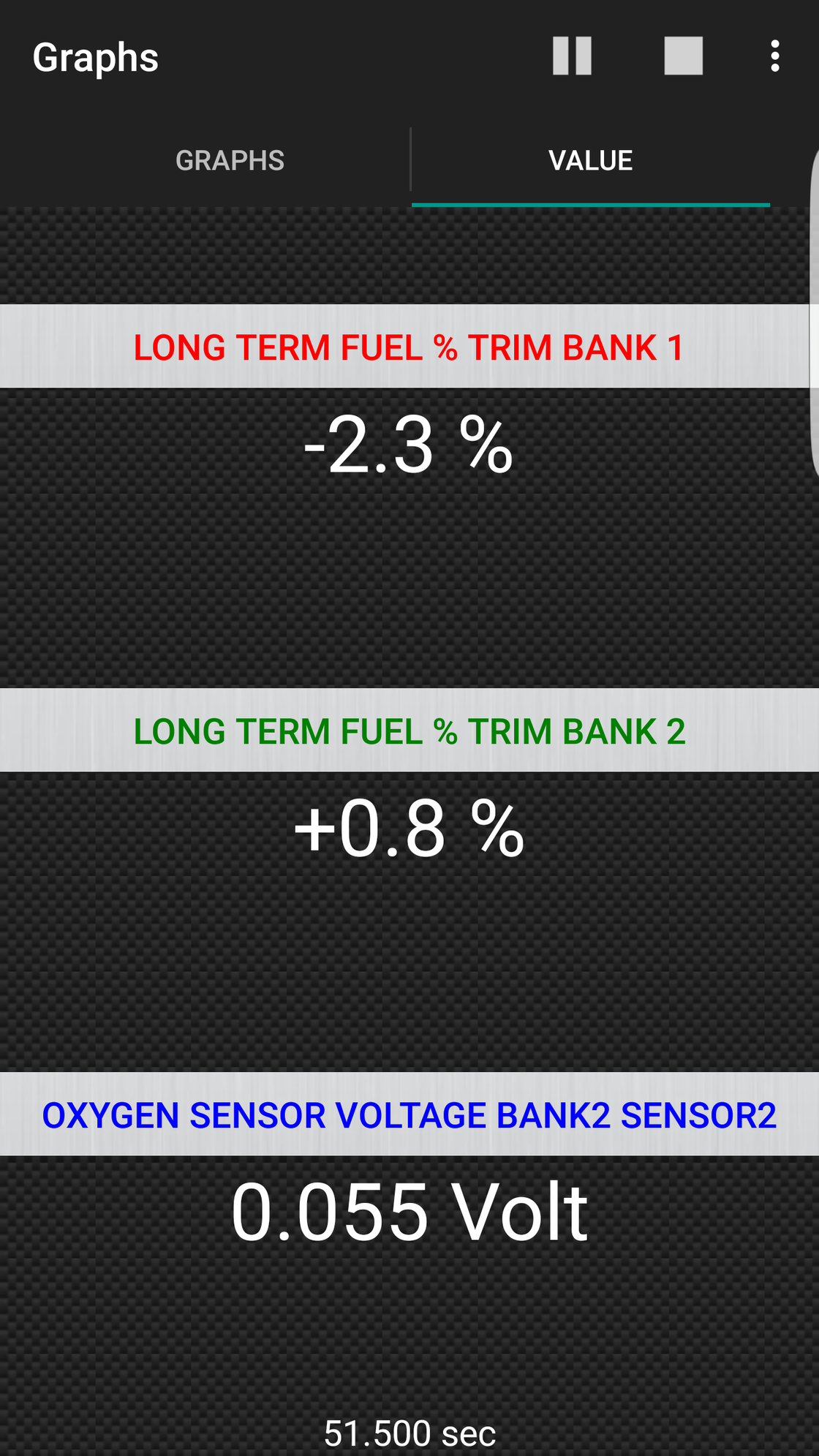

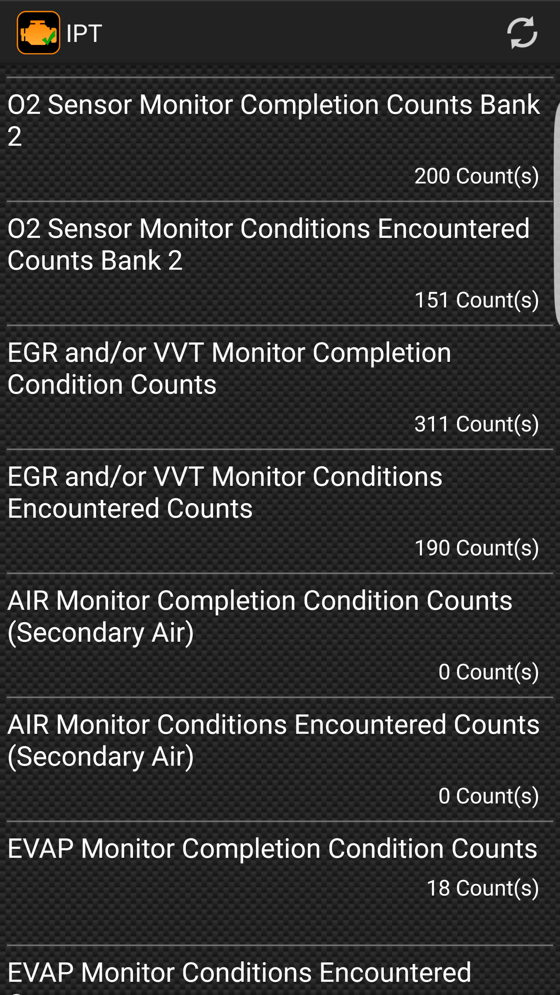

go here and get a copy of this program it will allow you to get the most out of it.http://www.outilsobdfacile.com/software-eobd-facile-elm327.php
This what I found for o2 sensor and fuel trim
Old May 12, 2017 | 02:46 AM
  #47
Ducmon's Avatar
Joined: Mar 2016
Posts: 630
Likes: 133
From: Near Berlin Germany
ok now we are getting some where. If this was a tick over, or the results just after giving gas then it looks like you still have air leak but do the test correctly.
If you set it up on graphs to read the long term fuel trim on both banks on tick over
It should be level. When you give gas if it drops and then goes up when you stop then you have an air leak still
If this the case.
sent up graphs on the short-term fuel trims. When you spray the brake fluid and find the point where there is the air leak it will drop once more.
This will find even the smallest air leak.

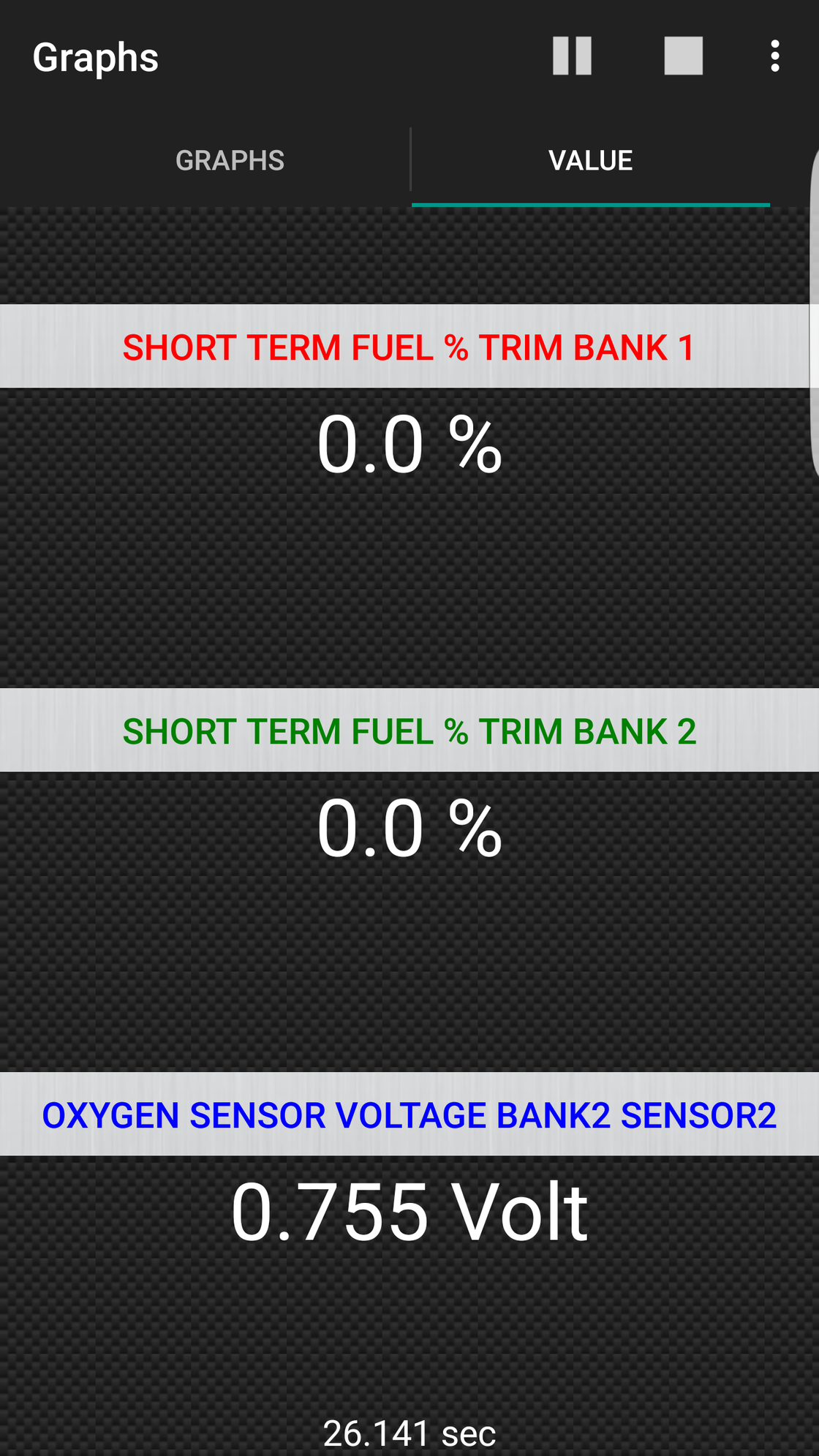

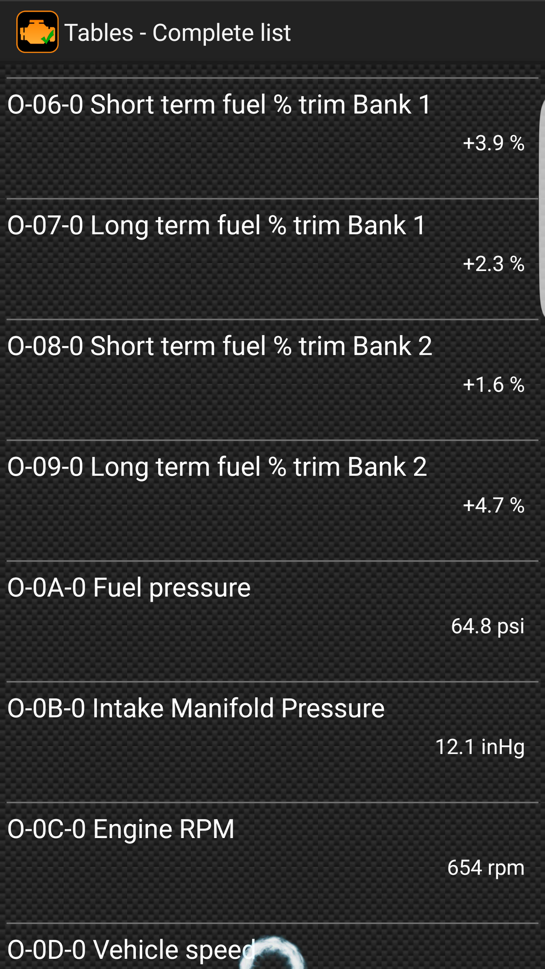

Originally Posted by Ducmon
Are you using a phone to do these tests because I just tried it and you can not see enough details on the graphs. I always use a laptop.
When I tried with a totally cold engine I got short term 0%
long term +3.5%
This was at tick over.
This is correct because the engine has to be rich a little bit until warm
This test should be done with a warm engine.
Just do one test at a time on one bank, then the other, so that we don't get lost with all the information.
This from me just being in parked after the car warmed up
this from me moving the car
the short fuel trims stayed the samealso from me moving and stopping
It still looks like you have an air leak on bank two.
set the device to short-term fuel trim and spray brake cleaner in the near of the pipe work when the read drops you have found the point.
