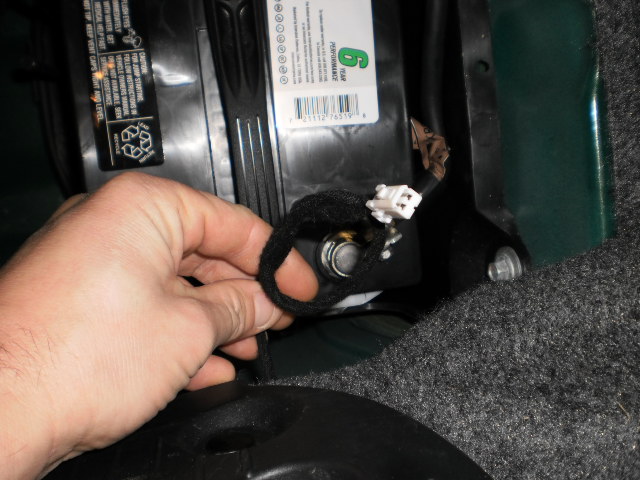

Common problem with 2000-2002 S Type vehicles. Open trunk and lift carpet covering spare tire. Look for signs of water intrusion. Look for small white 2 pin connector next to battery. Maybe hard to find but keep looking. Those connectors get water in them and corrode and can cause alarm to go off. This connector is for vehicle transit relay, for when car is new and being transported that battery does not go dead. If you find connector just cut off connector and put electrical tape around open wire. Also open and check remote for car. Can get nasty in there and may need to be clean. You may have to take to dealership and have them look up last alarm data which would tell them what was causing alarm.
Thank you! I will do this. As of now I'm upset thought because I just went outside to start the car and it won't even turn all the way over. I'm waiting on my son to come over and we will look at it and use your suggestions.

Okay I got someone to jump the battery and he also looked for that cable. I showed him the pic. He says there's only a black cable and he's afraid to do anything to it. He did see some water though. I am so frustrated right now. It won't turn over.
