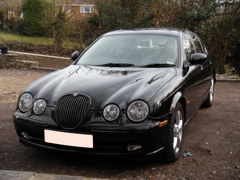

Can anyone possibly give me a simple answer to this problem or am I looking at a specialised garage.
For whatever reason my 6 CD changer has started to constantly give me a message of " CDC No Disc". I ahve to admit to palying copied discs but they have played in the past.
I have picked up a few threads which although may be straight forward to the authors, I'm afraid I need the "Dummies Guide".
It's a late 2003 S-Type Sport 3.0 V6 Petrol. The CD Changer is mounted in the boot so would need instructions on how to remove it before taking it apart to look at worm drives or anything else!!.
Would greatly appreciate any help and many thanks in advance.
