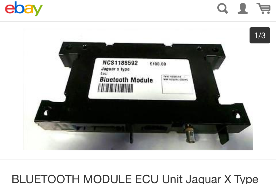

However you can also fit the later X-type bluetooth interface, UK part number 7W93 10D893 AB, into the s-type. This is a one module unit in the boot, again fitted to the d2b system, with a bluetooth antenna that plugs in to it.
You will still need the microphone and the link in the voice control connector, unless you have the voice module.
This later unit is far better as you can have more than one phone linked to it and it has a singal meter in the display (If you have one.)
It also saves on instalation time and may work on more modern phones, but I am unsure about that last bit?
However as I mentioned even the newer X-type module will only give you bluetooth phone calls, no texts and no music.
