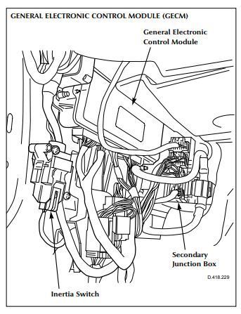

Do you know where the GECM is located?
I found a unit marked front general module in the divers Kick panel.
Not sure if that's the same thing. Thinking if I can disconnect it there it would rule out a grounding issue.in the door.
You are correct I have the double door locking.

Here's the location from the training guide for early models, page 76:
http://www.jagrepair.com/images/Auto...G%20S_Type.pdf
Sounds like you were in the right place. It's outboard of the US driver's feet, just forward of the inertia switch.

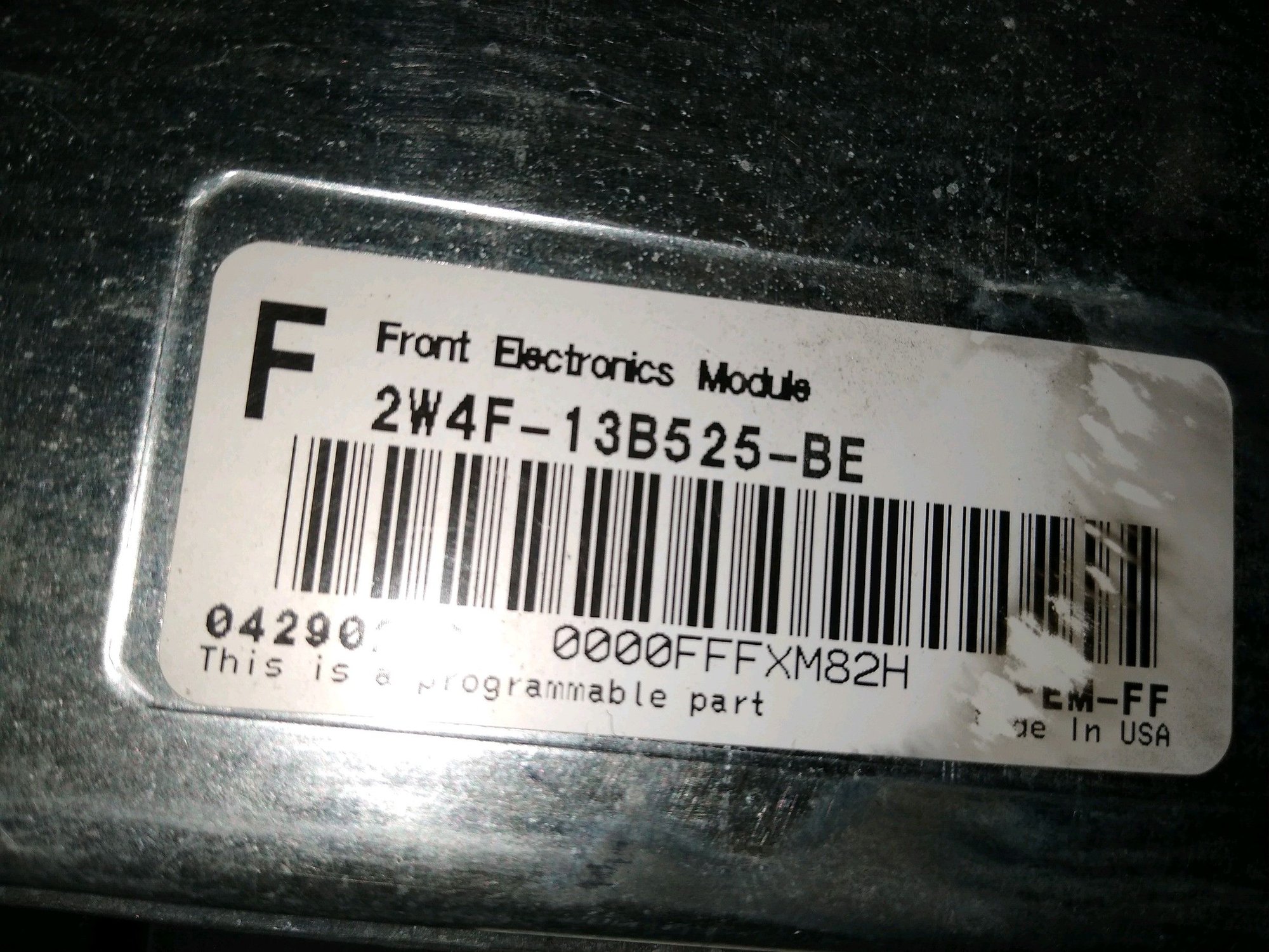

I have found one on fleabay but not sure if it will work.
The bold numbers match at the top 2WF 13B252 BE but there are at the bottom that do not.
Anyone know if it will work?
link to flebay item https://www.ebay.com/itm/03-Jaguar-S...kAAOSwWkdd6VCs
