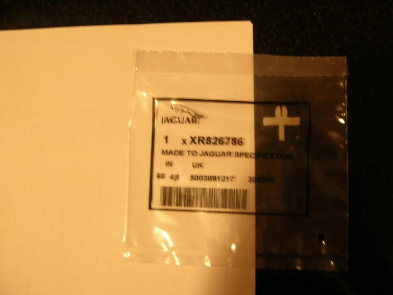

Ok Jon, more than likely the little plastic (heres your sign ) "X" clip has failed. Pictured below is the clip and part number. There is a white dowel (as seen in picture) Once the new clip is inserted push the white dowel into the X clip and through the door frame. The X clips are cheap, I would purchase a couple as you might break the next upper one, when trying to replace the lower one.
Joyces was actully broken when I picked up our vehicle a few years back. I used "GOOP Automotive Trim Glue" available at The Zone etc... I applied the GOOP to the trim and clamped it overnight, it held for a long time, until I did the chrome polishing.
BTW I forgot to say a prayer about the plastics in our Jags this morning.
Attached Thumbnails Chrome Window Trim Separation....-aluminum-window-trim-011e.jpg   Chrome Window Trim Separation....-chrome-trim.jpg

Thanks as always, Rick. That spot you marked is exactly where our trim has lost its grip. I'll get some of these clips next time I'm near the dealership. I may clip it AND glue it. If I get mad enough at it, I just may screw that corner piece down on both sides of the car....
What is the best tool (and method) to use to pull the chrome trim away from that area to remove the failed clip and install the new clip without creasing or bending the trim?
From your photo, it appears that re-installation involves pushing the clip into the door first, getting it positioned correctly, then snapping the chrome trim onto it. I assume the trim has a channel on the back that pops into the clip....
