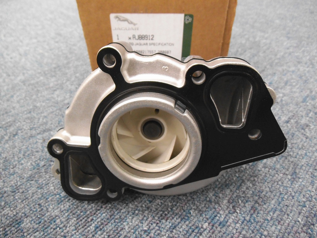

Do NOT buy a Jaguar water pump!
I have posted this before but ALL 4.0L, 4.2L and Lincoln LS 3.9L V-8's as well as Land Rover 4.2L and 4.4L V-8's use the same water pump. Get the Lincoln LS one and look for the improved aftermarket one. The box will say improved over stock on it. They have improved the impeller and seals.
It's easy to get and has a lifetime warranty from Oreilly. I got one at 9PM on a Sunday night. CP4124 about $90.
Import Direct Water Pumps CP4124 - Water Pump | O'Reilly Auto Parts
Again IF you want Jaguar parts we have a 15% discount for forum member's and free shipping on orders over $50 from Jaguar Greenville, SC.
864-288-7575. Be sure and mention the forum and ask for the discount. I have used this several times.

Water pump impeller design has changed over the years, (and there are TSB's concerning this) and the current Jaguar pump (AJ88912) is $89 at most online Jaguar dealers like Las Vegas and Terry's. IDC's CP4124 are Chinese.

Again I have been thru this before. Jaguar is very late to the party on this and should have released an upgraded version years earlier. I use the aftermarket Chinese one.
Where is the factory one made? Does it come with a lifetime warranty? No of course not.
I only replace radiators when I have to. Just too expensive and too much work. I don't consider them a wear item.
Good luck with your vehicle, but your information concerning this issue isn't accurate. Pumps with white poly phenyl sulphide impellers have been produced since early 2000's. (new style) It was first introduced on the XK serial 040101 and XJ 308 at serial 873500. Black Nylon 66 (old style) hasn't been used since 96~98. Jaguar is neither late to the party, nor are they poor quality or Chinese. Good luck with your "lifetime" warranty.

Sorry wrong again!
I come from the Lincoln LS side where this failure came much earlier than S Type because Ford sold a lot more LS's especially in 2000. That's why I don't even tell them it's for an S Type. Shop for the LS pump instead.
Get the one you want it's your car!
Still did not answer what the warranty is on the Jaguar branded pump??
It's NOT lifetime. Again make your own choice.
I did.
