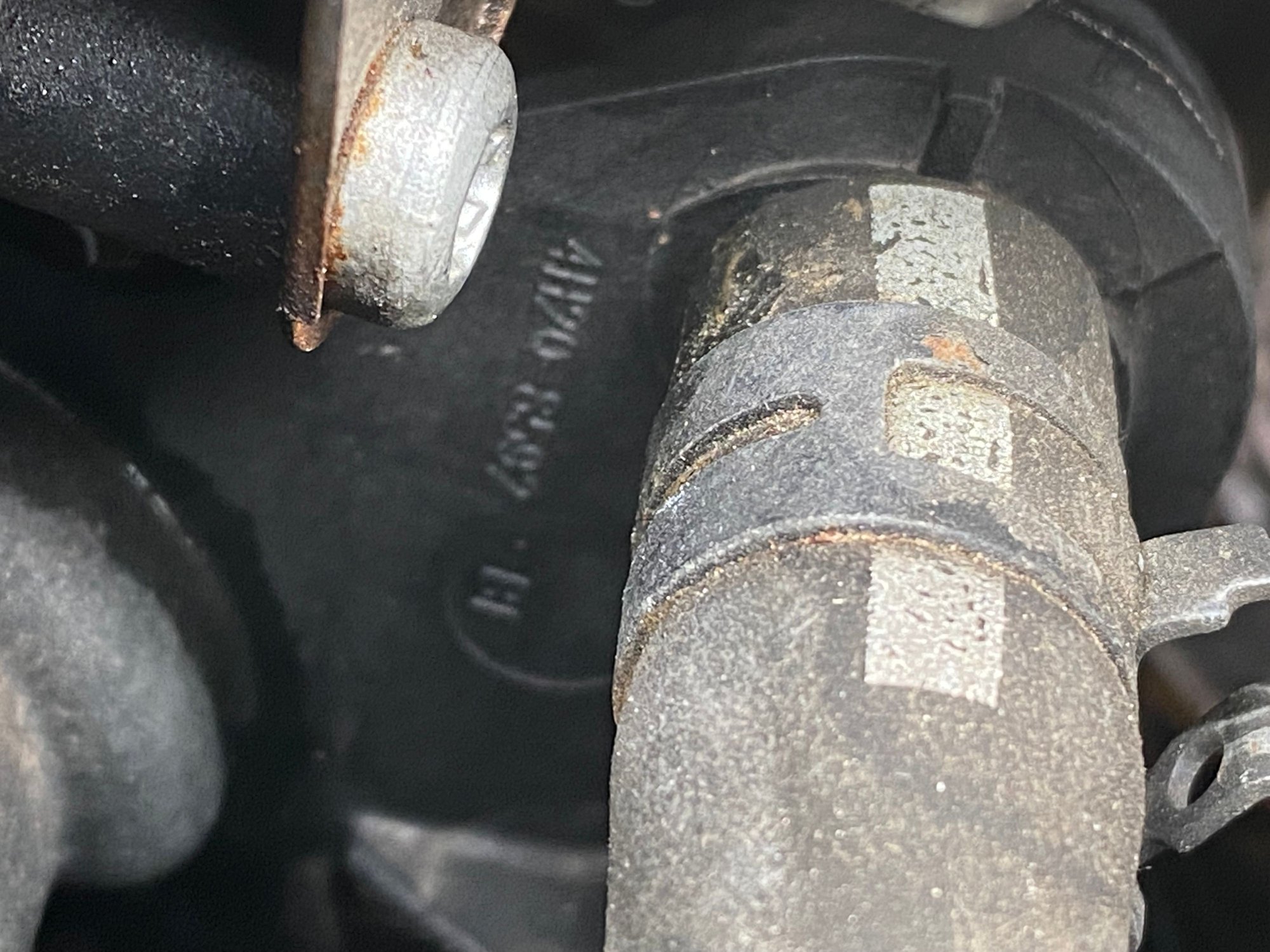

Ok, Morning all firstly great shout on the pressure test, id done it before and it only dropped 1/1.5 psi over 45 mins before however this time I took the engine cover off and looked down and I could see it was wet, i wasnt sure if it was oil so I proceeded to pressure test now excuse my terminology but I found my problem, the pipe that leads out the coolant tank goes into something and its the something its leaking from. under pressure it really gave. As you can see ive added photos and its the something with the numbers on that is leaking, anyone know how easy that is to replace and what it is.. again sorry for my lack of knowledge.

Yep turns out its coming out the Thermostat Housing I think its called, its visible. Could that have anything to do with the other issue?
Possible, but no guarantees. From Troubleshooting 101: Fix the known problems before digging deeper elsewhere.
Well managed to sort the leak and have ordered a heating control valve as when I had the front wheel off and liner I could see the existing one and it looks rather cruddy and as they arent expensive will replace and see what happens. fuses are fine also
