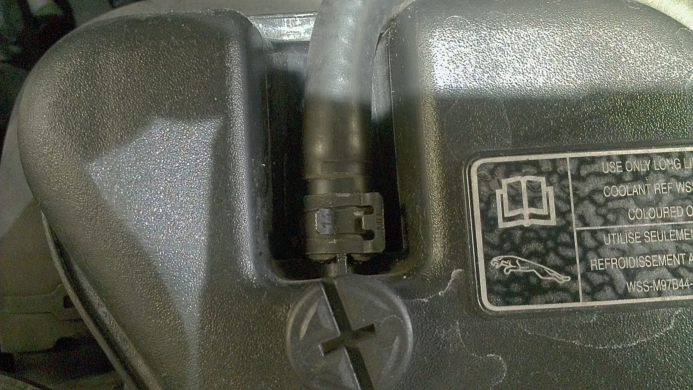

I had a coolant leak that started slow and became more problematic.
In order to analyze and fix the problem I did the following:
1) waited for the engine to cool for a couple of hours, washed the engine and refilled the reservoir tank, and then waited for the engine to dry
2) drove the s-type for 5miles and checked under the hood to see where the leak was coming from. I noticed coolant appearing in the area under the reservoir breather tube connection as many have mentioned in this post
3) went back to the house waited for the engine to cool for a couple of hours and pulled the breather tube off carefully to inspect the nipple. It felt solid but I believe there is a hair line crack at the base of the nipple.
4) I rotated the retainer clip 180 degrees to maximize the pressure I needed to press the hose against the left side of the nipple where I believe the crack was located and positioned the tube and collar as snug up to the reservoir as possible (see picture)
5) cleaned engine and refilled reservoir
6) confirmed no more leaking
I'm not sure how long this will last, but as of now, it has at least fixed my issue without purchasing a new tank. Also, I think having the retainer clip closer to the mouth of the hose makes a better seal given that the hose is more easily compressed at the end vs in the middle. Further this is a problem area of the reservoir. Having max compression in this area could prolong the life of the tank as it has in my case.
Hope it helps.

clsimmon
I had done the same as you did. It lasted less than 2 months & the nipple broke off under coolant pressure build up. Get ready to order a new reservoir soon.

The picture totalimortal 363 has of the reservoir top tank, be CAUTIOUS. The tank is plastic. After many miles and a lot of heat, the small male fitting the return hose fits on, breaks from the top reservoir body. It will break just from age and heat and some one "working in the area hitting it." The male plastic fitting is normal and has a normal widening flange at the end for the rubber tube to fit over. At first the male flange was only about 3/8" long. I tried Numerous HOSE CLAMPS and it continued to have a small leak. What I didn't realize was the 1/2" to 3/4" male flange had broke and was actually stuck farther in the rubber hose. For fear of driving to Palm Springs and doing major heat damage to my car, I had it fixed and learned about the male "nipple" or flange had broken off to a shorter length.
There are certain parts you learn to replace at certain intervals, I will now change my batteries every three years and this top reservoir about every seven years, depending on mileage or usage.
Because of the male flange or tube breaking, in the last year I've changed the top reservoir on both my 2005S and 2007 XJ (both cars have over 110,000 miles.) My 2008 XJ VPlas only has ~50,000 miles so I'm not worried about the heat affecting it yet. For my cars, this is the exact same part, even though different models and engines.

Hmm 8 days, seems just about the same time your mechanic broke your grill opening your stuck hood. It could be possible he hit the nipple on top the tank and cracked it. If it were truly cracked or broken there would be obvious signs of leakage on and around the top (nipple/hose).
Originally Posted by hilaryv215
How hard is it to pull out to check in the 3.0 s type?
Do I have to be wary of knocking into anything ?
It is not difficult to remove BUT I would NOT, as if it has not been replaced it has a very good chance of breaking. When indoubt replace, they are not that expensive and can be found on Amazon and Ebay. "Wary ofknocking" oh hell yeah, reread last 2 sentences!
Post #88 shows the picture of the nipple.
